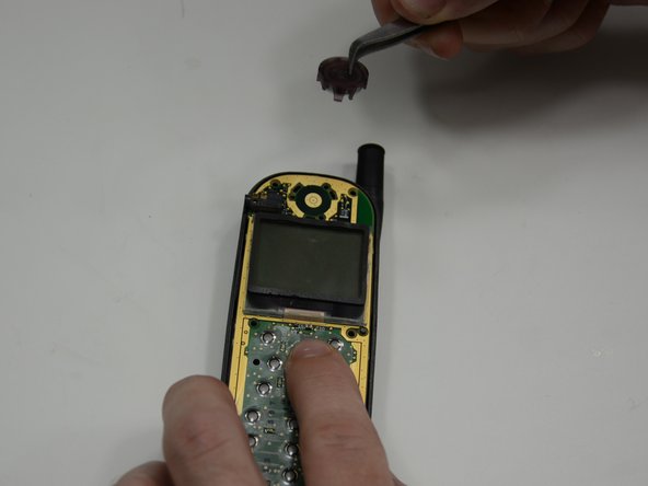

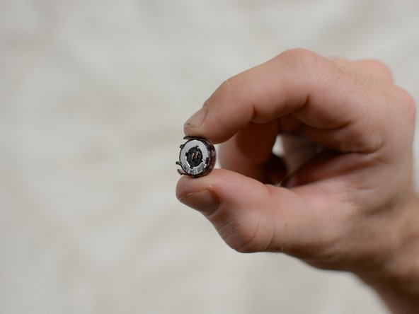

  5. Kyocera QCP-2035 Speaker Replacement, Speaker: crwdns2935265:05crwdnd2935265:01crwdnd2935265:03crwdne2935265:0 Kyocera QCP-2035 Speaker Replacement, Speaker: crwdns2935265:05crwdnd2935265:02crwdnd2935265:03crwdne2935265:0 Kyocera QCP-2035 Speaker Replacement, Speaker: crwdns2935265:05crwdnd2935265:03crwdnd2935265:03crwdne2935265:0
    • Locate the speaker at the top of the phone right above the screen.
    • Using a spudger or pair of tweezers, gently rock and pry from between the speaker and the main board.
    • There are three plastic tabs holding the speaker, which are located at the back of the speaker.
