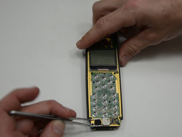

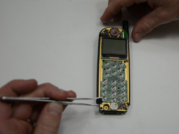

  5. Kyocera QCP-2035 Microphone Replacement, Microphone: crwdns2935265:05crwdnd2935265:01crwdnd2935265:03crwdne2935265:0 Kyocera QCP-2035 Microphone Replacement, Microphone: crwdns2935265:05crwdnd2935265:02crwdnd2935265:03crwdne2935265:0 Kyocera QCP-2035 Microphone Replacement, Microphone: crwdns2935265:05crwdnd2935265:03crwdnd2935265:03crwdne2935265:0
    • Locate the microphone at the bottom left corner of the phone.
    • using tweezers, Lift the microphone straight out of the phone.
