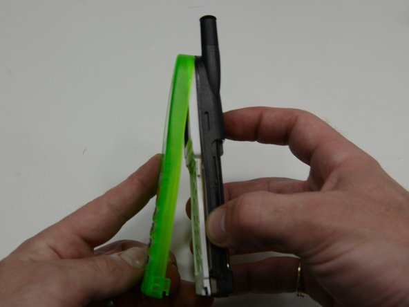

    • When looking at the back of the phone, you will see a horizontal line and three raised segments of plastic in the form of a triangle.
    • Place thumb on top of the triangle and press into the phone while sliding your thumb towards the bottom of the phone.
    • In 5 mm it will stop sliding.

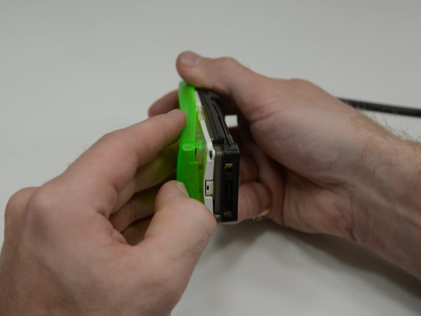

  3. Kyocera QCP-2035 Display Replacement: crwdns2935265:03crwdnd2935265:01crwdnd2935265:03crwdne2935265:0 Kyocera QCP-2035 Display Replacement: crwdns2935265:03crwdnd2935265:02crwdnd2935265:03crwdne2935265:0 Kyocera QCP-2035 Display Replacement: crwdns2935265:03crwdnd2935265:03crwdnd2935265:03crwdne2935265:0
    • Rotate the phone so the bottom is facing you. There is a small indent on the plastic face.
    • Using the tip of your fingernail or a spudger, pry the cover away from the rest of the phone.
    • Once the cover starts to part, keep separating until the top notches detach.

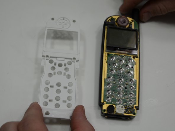

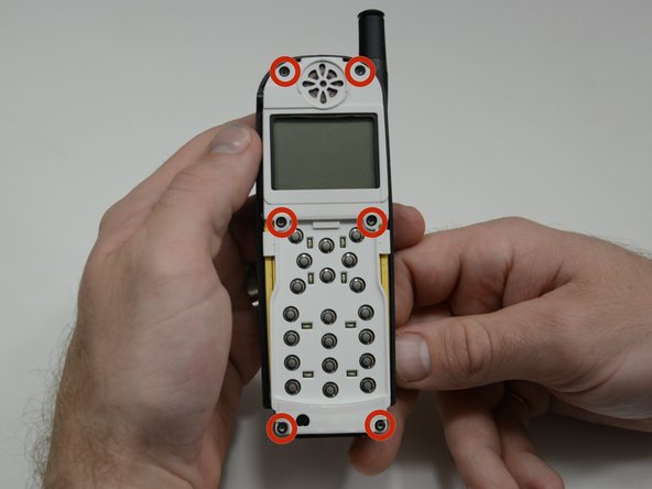

  4. Kyocera QCP-2035 Display Replacement: crwdns2935265:04crwdnd2935265:01crwdnd2935265:03crwdne2935265:0 Kyocera QCP-2035 Display Replacement: crwdns2935265:04crwdnd2935265:02crwdnd2935265:03crwdne2935265:0 Kyocera QCP-2035 Display Replacement: crwdns2935265:04crwdnd2935265:03crwdnd2935265:03crwdne2935265:0
    • With the cover plate separated, you will see (6) T6x11mm torx screws recessed in the white plastic.
    • Remove screws.
    • The white plastic face plate lifts right off, exposing the main board.

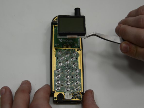

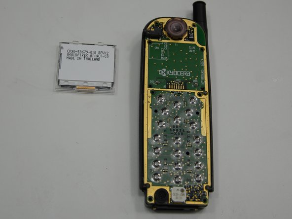

  5. Kyocera QCP-2035 Display Replacement, Display: crwdns2935265:05crwdnd2935265:01crwdnd2935265:03crwdne2935265:0 Kyocera QCP-2035 Display Replacement, Display: crwdns2935265:05crwdnd2935265:02crwdnd2935265:03crwdne2935265:0 Kyocera QCP-2035 Display Replacement, Display: crwdns2935265:05crwdnd2935265:03crwdnd2935265:03crwdne2935265:0
    • Lift the display straight up, by either grabbing it on it's sides, or sliding a pair of tweezers between the screen and the main board.
    • There are four straight plastic pins on the underside corners of the screen that hold it in place.
