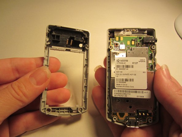

  3. Kyocera Marbl K127 Keyboard Replacement, Remove the phone backing.: crwdns2935265:03crwdnd2935265:01crwdnd2935265:03crwdne2935265:0 Kyocera Marbl K127 Keyboard Replacement, Remove the phone backing.: crwdns2935265:03crwdnd2935265:02crwdnd2935265:03crwdne2935265:0 Kyocera Marbl K127 Keyboard Replacement, Remove the phone backing.: crwdns2935265:03crwdnd2935265:03crwdnd2935265:03crwdne2935265:0
    • Use the Y1 tri-wing screwdriver to remove the four 2.4mm screws and then pry the entire backing off of the phone including the black clip attached to the top of the motherboard.

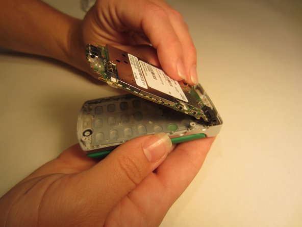

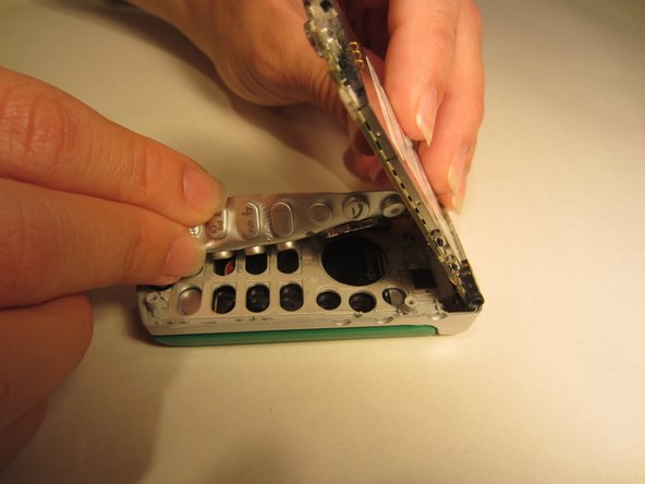

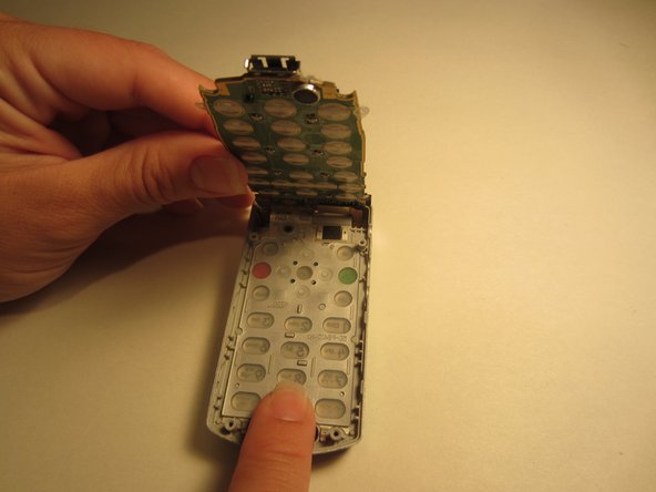

  4. Kyocera Marbl K127 Keyboard Replacement, Remove the existing keyboard.: crwdns2935265:04crwdnd2935265:01crwdnd2935265:03crwdne2935265:0 Kyocera Marbl K127 Keyboard Replacement, Remove the existing keyboard.: crwdns2935265:04crwdnd2935265:02crwdnd2935265:03crwdne2935265:0 Kyocera Marbl K127 Keyboard Replacement, Remove the existing keyboard.: crwdns2935265:04crwdnd2935265:03crwdnd2935265:03crwdne2935265:0
    • Lift the motherboard away from you to locate the existing keyboard and remove it.

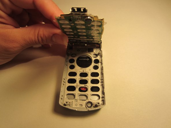

  5. Kyocera Marbl K127 Keyboard Replacement, Install the new keyboard.: crwdns2935265:05crwdnd2935265:01crwdnd2935265:03crwdne2935265:0 Kyocera Marbl K127 Keyboard Replacement, Install the new keyboard.: crwdns2935265:05crwdnd2935265:02crwdnd2935265:03crwdne2935265:0 Kyocera Marbl K127 Keyboard Replacement, Install the new keyboard.: crwdns2935265:05crwdnd2935265:03crwdnd2935265:03crwdne2935265:0
    • Hold the new keyboard in your hand facing you as it would look in your cell phone, lift the motherboard with your opposite hand, and then flip the keyboard face down and fit it in to place.
