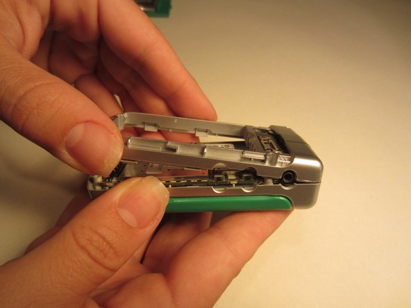

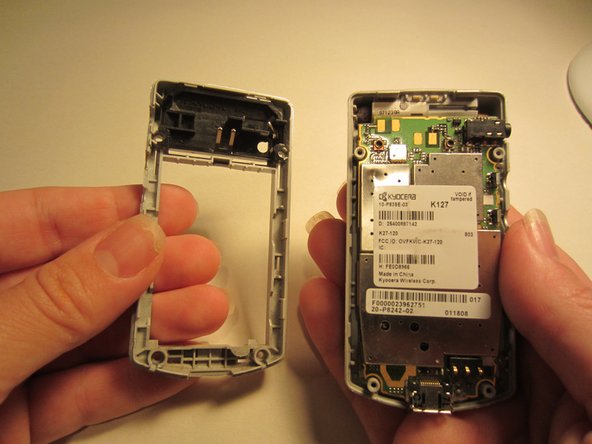

  3. Kyocera Marbl K127 Headphone Jack Replacement, Remove the phone backing.: crwdns2935265:03crwdnd2935265:01crwdnd2935265:03crwdne2935265:0 Kyocera Marbl K127 Headphone Jack Replacement, Remove the phone backing.: crwdns2935265:03crwdnd2935265:02crwdnd2935265:03crwdne2935265:0 Kyocera Marbl K127 Headphone Jack Replacement, Remove the phone backing.: crwdns2935265:03crwdnd2935265:03crwdnd2935265:03crwdne2935265:0
    • Use the Y1 tri-wing screwdriver to remove the four 2.4mm screws and then pry the entire backing off of the phone including the black clip attached to the top of the motherboard.

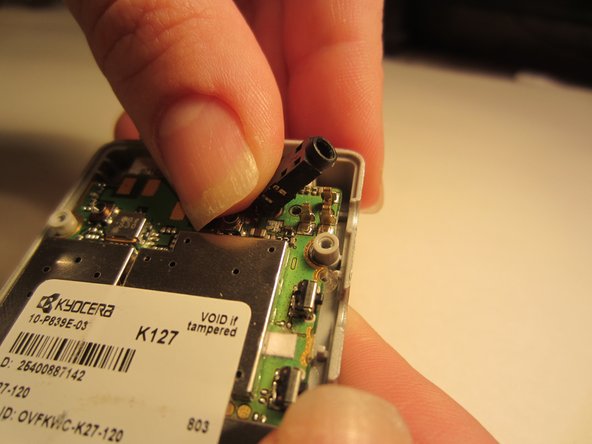

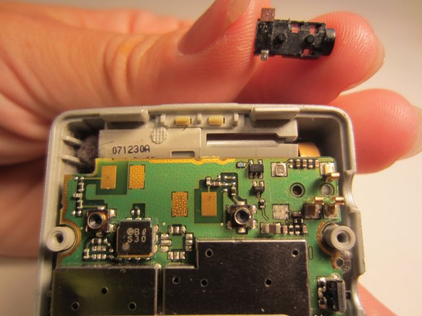

  4. Kyocera Marbl K127 Headphone Jack Replacement, Remove existing headphone jack.: crwdns2935265:04crwdnd2935265:01crwdnd2935265:03crwdne2935265:0 Kyocera Marbl K127 Headphone Jack Replacement, Remove existing headphone jack.: crwdns2935265:04crwdnd2935265:02crwdnd2935265:03crwdne2935265:0 Kyocera Marbl K127 Headphone Jack Replacement, Remove existing headphone jack.: crwdns2935265:04crwdnd2935265:03crwdnd2935265:03crwdne2935265:0
    • Locate the headphone jack attached to the top right of the motherboard and pull it off using your thumb and index fingers.
