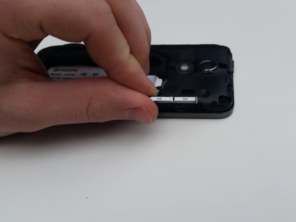

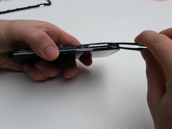

  6. Kyocera Hydro Vibe Volume Button Replacement, Volume Button: crwdns2935265:06crwdnd2935265:01crwdnd2935265:03crwdne2935265:0 Kyocera Hydro Vibe Volume Button Replacement, Volume Button: crwdns2935265:06crwdnd2935265:02crwdnd2935265:03crwdne2935265:0 Kyocera Hydro Vibe Volume Button Replacement, Volume Button: crwdns2935265:06crwdnd2935265:03crwdnd2935265:03crwdne2935265:0
    • Once you have taken out the trim, the volume button will be easily removable.
    • Locate the volume button, if you are looking at the back of the phone (battery side) then it will be on the right side.
    • Take the tweezers and remove the button.
