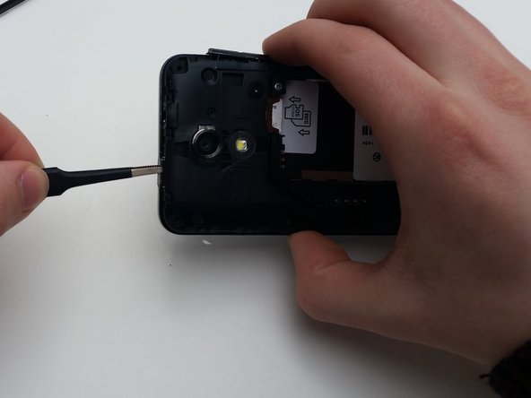

  3. Kyocera Hydro Vibe Lock Button Replacement, Trim: crwdns2935265:03crwdnd2935265:01crwdnd2935265:01crwdne2935265:0
    • Locate the screws holding the trim which are the four side screws on each corner.
    • Remove each screw with a Phillips screw driver #J00. The screws are 5mm Phillips.

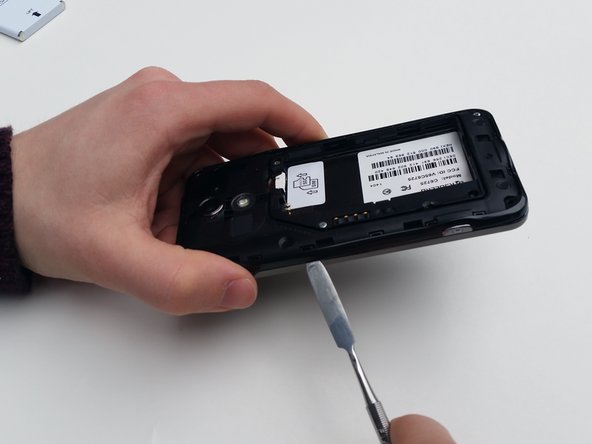

  4. Kyocera Hydro Vibe Lock Button Replacement: crwdns2935265:04crwdnd2935265:01crwdnd2935265:02crwdne2935265:0 Kyocera Hydro Vibe Lock Button Replacement: crwdns2935265:04crwdnd2935265:02crwdnd2935265:02crwdne2935265:0
    • Locate the clasps holding the trim in place.
    • You will need to insert the metal spudger through the bottom of the trim and slowly push upwards to release the clasps.

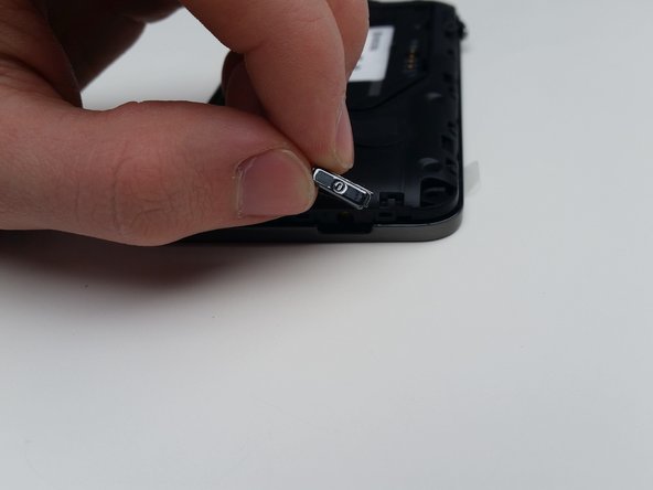

  6. Kyocera Hydro Vibe Lock Button Replacement, Lock Button: crwdns2935265:06crwdnd2935265:01crwdnd2935265:03crwdne2935265:0 Kyocera Hydro Vibe Lock Button Replacement, Lock Button: crwdns2935265:06crwdnd2935265:02crwdnd2935265:03crwdne2935265:0 Kyocera Hydro Vibe Lock Button Replacement, Lock Button: crwdns2935265:06crwdnd2935265:03crwdnd2935265:03crwdne2935265:0
    • Once you have taken the trim apart, the lock button will be easily removable.
    • The lock button is located on the top of the phone.
    • Take the tweezers and remove the lock button.
