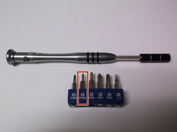

    • Use a PH00 screwdriver to remove the 6 screws from the mid-frame.
    • 4 screws located around the border of the phone, 2 located around the battery terminal.
    • Press down and firmly turn screws to prevent slippage. Avoid letting the screw driver slip, as this will result in stripped screws and prevent further progress.

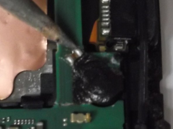

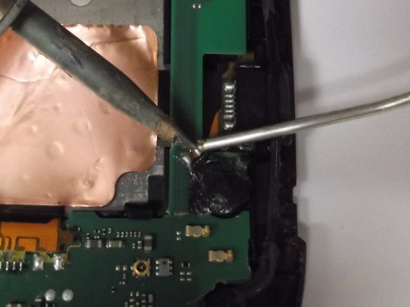

    • Plug in solder iron, allow 2-4 minutes to come to temperature.
    • Apply solder iron to each speaker terminal, and melt connection.
    • When connection is melted, use tweezers to remove defective speaker from the motherboard.
    • Solder cools quickly, so the connections will solidify without heat.
    • Avoid dripping, adding, or removing solder to prevent short circuitry.
  8. Kyocera Hydro Life Main Speaker Replacement: crwdns2935265:08crwdnd2935265:01crwdnd2935265:02crwdne2935265:0 Kyocera Hydro Life Main Speaker Replacement: crwdns2935265:08crwdnd2935265:02crwdnd2935265:02crwdne2935265:0
    • Insert new speaker into speaker slot.
    • Solder new positive and negative terminals.
    • Align connection points, apply solder iron to motherboard connection points, then apply solder to heated connection for precise application.
