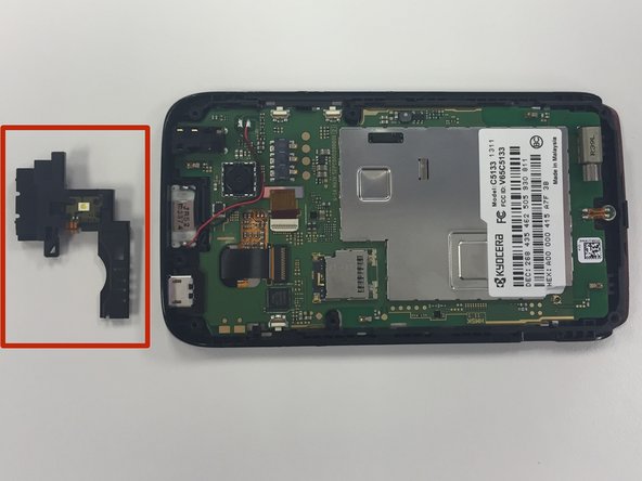

  5. Kyocera Event Motherboard Replacement, Motherboard: crwdns2935265:05crwdnd2935265:01crwdnd2935265:02crwdne2935265:0 Kyocera Event Motherboard Replacement, Motherboard: crwdns2935265:05crwdnd2935265:02crwdnd2935265:02crwdne2935265:0
    • Locate the black L-shaped cover at the top center of the phone.
    • Remove the piece, including the attached ribbon, and set it aside.

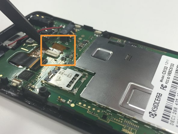

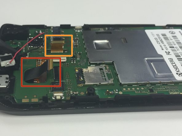

  6. Kyocera Event Motherboard Replacement, Disconnect Cables: crwdns2935265:06crwdnd2935265:01crwdnd2935265:03crwdne2935265:0 Kyocera Event Motherboard Replacement, Disconnect Cables: crwdns2935265:06crwdnd2935265:02crwdnd2935265:03crwdne2935265:0 Kyocera Event Motherboard Replacement, Disconnect Cables: crwdns2935265:06crwdnd2935265:03crwdnd2935265:03crwdne2935265:0
    • Use a spudger to carefully disconnect the black cable.
    • Use the spudger to carefully disconnect the brown cable.

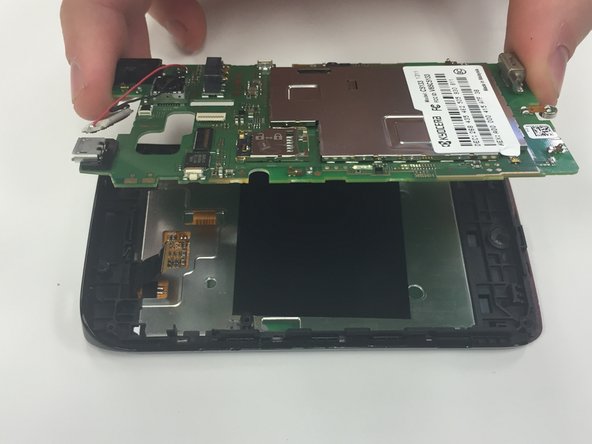

  7. Kyocera Event Motherboard Replacement: crwdns2935265:07crwdnd2935265:01crwdnd2935265:02crwdne2935265:0 Kyocera Event Motherboard Replacement: crwdns2935265:07crwdnd2935265:02crwdnd2935265:02crwdne2935265:0
    • Locate the hook at the bottom of the phone. Use the spudger unlatch the hook connecting the motherboard to the front assembly of the phone.
    • Using your fingers, gently grab the motherboard and pull.
  8. Kyocera Event Motherboard Replacement: crwdns2935265:08crwdnd2935265:01crwdnd2935265:01crwdne2935265:0
    • Prior to removing the motherboard, remove the speaker from the top of the device.
  9. Kyocera Event Motherboard Replacement: crwdns2935265:09crwdnd2935265:01crwdnd2935265:01crwdne2935265:0
    • Using fingers, remove the motherboard from its casing.
