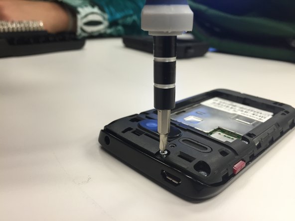

  3. Kyocera Event Ear Piece Speaker Replacement, Remove the screws.: crwdns2935265:03crwdnd2935265:01crwdnd2935265:02crwdne2935265:0 Kyocera Event Ear Piece Speaker Replacement, Remove the screws.: crwdns2935265:03crwdnd2935265:02crwdnd2935265:02crwdne2935265:0
    • Remove seven of the 4.9mm tri-head screws. Keep them in a secure location.

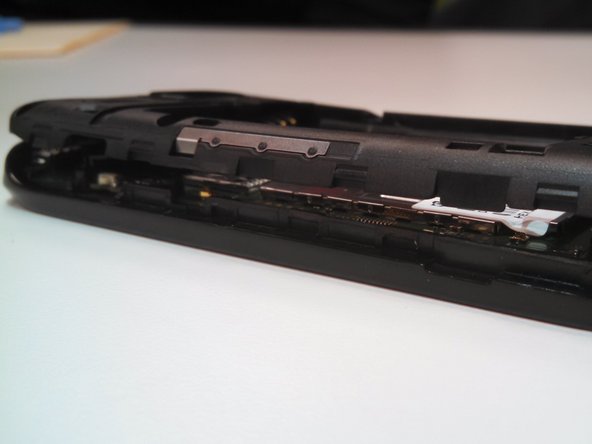

  4. Kyocera Event Ear Piece Speaker Replacement, Remove the back assembly: crwdns2935265:04crwdnd2935265:01crwdnd2935265:03crwdne2935265:0 Kyocera Event Ear Piece Speaker Replacement, Remove the back assembly: crwdns2935265:04crwdnd2935265:02crwdnd2935265:03crwdne2935265:0 Kyocera Event Ear Piece Speaker Replacement, Remove the back assembly: crwdns2935265:04crwdnd2935265:03crwdnd2935265:03crwdne2935265:0
    • Pry the back assembly away from the body on all four sides of the phone.
    • Start prying at the top and work around.
    • Remove the buttons for the volume and power-this will allow for easier disassembly.
    • The back assembly is firmly attached to the body of the phone so removing it will require some force.

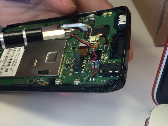

  5. Kyocera Event Ear Piece Speaker Replacement, Ear Piece Speaker: crwdns2935265:05crwdnd2935265:01crwdnd2935265:03crwdne2935265:0 Kyocera Event Ear Piece Speaker Replacement, Ear Piece Speaker: crwdns2935265:05crwdnd2935265:02crwdnd2935265:03crwdne2935265:0 Kyocera Event Ear Piece Speaker Replacement, Ear Piece Speaker: crwdns2935265:05crwdnd2935265:03crwdnd2935265:03crwdne2935265:0

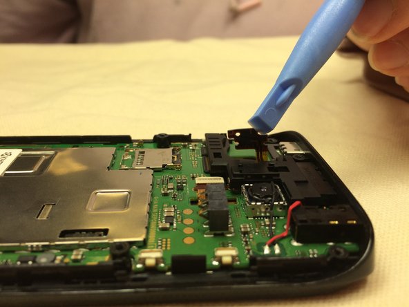

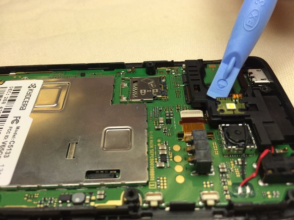

    • Soldering required to complete replacement
    • Start by un-attaching the small olive colored chip from the plastic casing.
    • The chip is connected to the phone by a small orange wire. Keep the wire connected to the chip and the phone body while removing the chip from the black plastic casing.
    • Pry underneath the chip with the plastic opener until it pops off. Leave the orange wires attached.

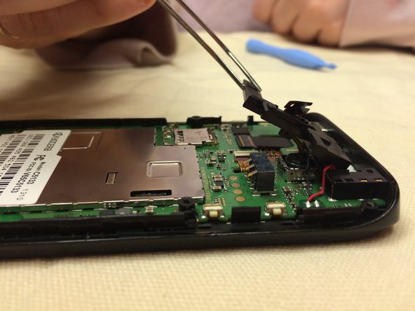

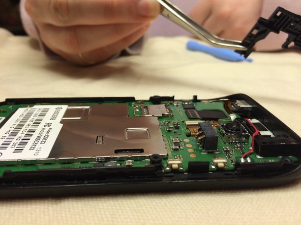

  6. Kyocera Event Ear Piece Speaker Replacement: crwdns2935265:06crwdnd2935265:01crwdnd2935265:03crwdne2935265:0 Kyocera Event Ear Piece Speaker Replacement: crwdns2935265:06crwdnd2935265:02crwdnd2935265:03crwdne2935265:0 Kyocera Event Ear Piece Speaker Replacement: crwdns2935265:06crwdnd2935265:03crwdnd2935265:03crwdne2935265:0
    • Use tweezers to lift up the black plastic cover.
    • The cover will pop out. Set it aside.
  7. Kyocera Event Ear Piece Speaker Replacement: crwdns2935265:07crwdnd2935265:01crwdnd2935265:03crwdne2935265:0 Kyocera Event Ear Piece Speaker Replacement: crwdns2935265:07crwdnd2935265:02crwdnd2935265:03crwdne2935265:0 Kyocera Event Ear Piece Speaker Replacement: crwdns2935265:07crwdnd2935265:03crwdnd2935265:03crwdne2935265:0

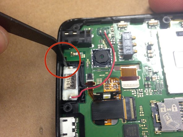

    • Speaker is magnetized.
    • Use a metal object to lift the speaker out OR use tweezers to grab underneath the top corner of the speaker and lift/pry it out.
  8. Kyocera Event Ear Piece Speaker Replacement: crwdns2935265:08crwdnd2935265:01crwdnd2935265:01crwdne2935265:0
    • Unsolder the speaker wires from the phone.
