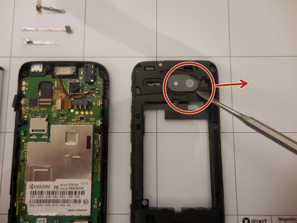

    • Next, use the metal spudger to pry at the plastic clips. Be careful to not to lose the power button and volume buttons as they fall out. Remove the plug for the camera flash.
  4. Kyocera Event Camera Lens Replacement: crwdns2935265:04crwdnd2935265:01crwdnd2935265:03crwdne2935265:0 Kyocera Event Camera Lens Replacement: crwdns2935265:04crwdnd2935265:02crwdnd2935265:03crwdne2935265:0 Kyocera Event Camera Lens Replacement: crwdns2935265:04crwdnd2935265:03crwdnd2935265:03crwdne2935265:0

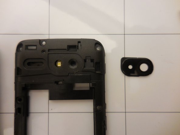

    • Use the spudger to pry the camera lens and remove it from the rear frame. Then you can replace the lens.
