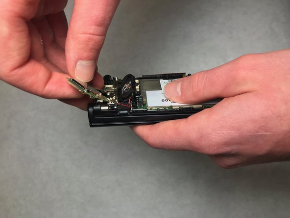

  7. Kyocera Echo Flash and Motherboard Replacement: crwdns2935265:07crwdnd2935265:01crwdnd2935265:01crwdne2935265:0
    • Wedge a plastic opening tool under the motherboard directly above the flash. Additionally, use a plastic opening tool to unhook corner labeled in a red square.
  8. Kyocera Echo Flash and Motherboard Replacement: crwdns2935265:08crwdnd2935265:01crwdnd2935265:02crwdne2935265:0 Kyocera Echo Flash and Motherboard Replacement: crwdns2935265:08crwdnd2935265:02crwdnd2935265:02crwdne2935265:0
    • Gently pull the motherboard out of its compartment.
