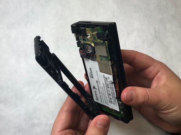

  6. Kyocera Echo Camera Replacement: crwdns2935265:06crwdnd2935265:01crwdnd2935265:02crwdne2935265:0 Kyocera Echo Camera Replacement: crwdns2935265:06crwdnd2935265:02crwdnd2935265:02crwdne2935265:0
    • Wedge a plastic opening tool under the black outer casing of the phone. Push the plastic opening tool down and outward while rotating the phone to pry the black outer casing off.
    • Do not apply too much pressure to the outer casing, as it could damage internal components.

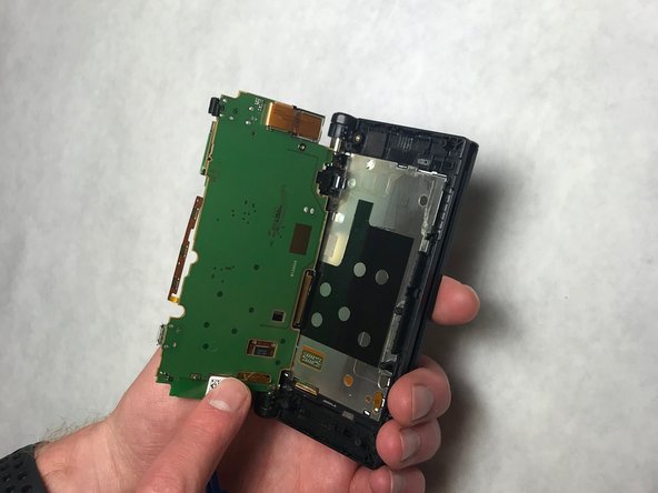

  7. Kyocera Echo Camera Replacement: crwdns2935265:07crwdnd2935265:01crwdnd2935265:02crwdne2935265:0 Kyocera Echo Camera Replacement: crwdns2935265:07crwdnd2935265:02crwdnd2935265:02crwdne2935265:0
    • Wedge a plastic opening tool under the bottom of the circuit board and push upward to separate the circuit board from the back of the phone.
    • Be careful to not break the circuit board as it is connected to the hinge.
  8. Kyocera Echo Camera Replacement: crwdns2935265:08crwdnd2935265:01crwdnd2935265:01crwdne2935265:0
    • Push the camera gently out of its housing towards the side of the circuit board it is connected at to dislodge it.
  9. Kyocera Echo Camera Replacement: crwdns2935265:09crwdnd2935265:01crwdnd2935265:01crwdne2935265:0
    • Grasp and pull up on the 32 pin connector attached to the circuit board to remove the camera.
