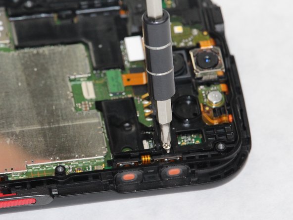

    • Remove the 2 screws with the same screwdriver bit.
    • Remove battery from the phone with plastic opening tool.

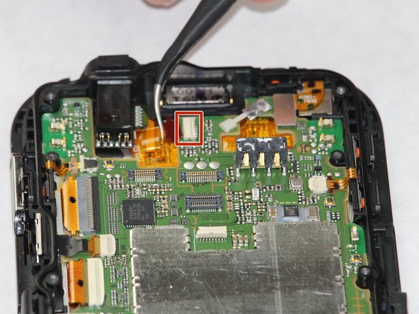

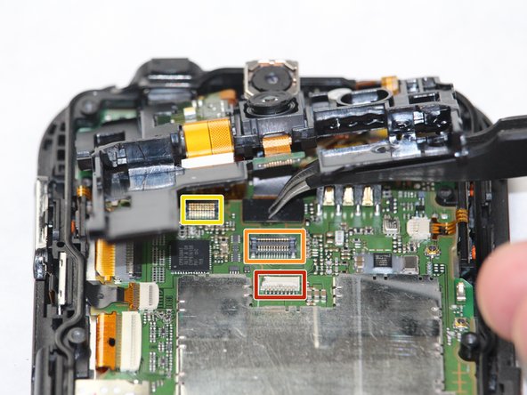

  3. Kyocera DuraForce Pro Headphone Jack Replacement: crwdns2935265:03crwdnd2935265:01crwdnd2935265:03crwdne2935265:0 Kyocera DuraForce Pro Headphone Jack Replacement: crwdns2935265:03crwdnd2935265:02crwdnd2935265:03crwdne2935265:0 Kyocera DuraForce Pro Headphone Jack Replacement: crwdns2935265:03crwdnd2935265:03crwdnd2935265:03crwdne2935265:0
    • Once the battery pops out, use tweezers to gently pull the ribbon out along with it.
    • Remove the 2 screws along the sides of the mounting bracket, then remove the bracket.

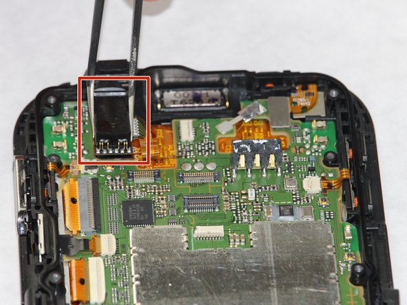

  4. Kyocera DuraForce Pro Headphone Jack Replacement: crwdns2935265:04crwdnd2935265:01crwdnd2935265:03crwdne2935265:0 Kyocera DuraForce Pro Headphone Jack Replacement: crwdns2935265:04crwdnd2935265:02crwdnd2935265:03crwdne2935265:0 Kyocera DuraForce Pro Headphone Jack Replacement: crwdns2935265:04crwdnd2935265:03crwdnd2935265:03crwdne2935265:0
    • Remove final ribbon cable, lift the latch up, and then slide it down. The audio jack will then slide out.
