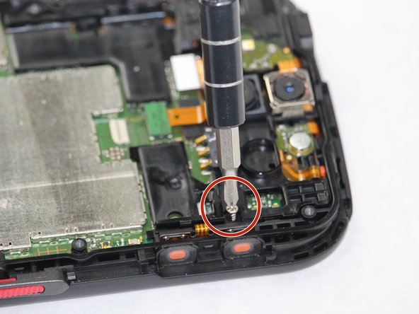

    • Remove the 8 screws around the outer portion of the phone with the JIS #0 screwdriver bit.
    • Use the plastic opening tool to remove the backside of the phone.
    • Slide the plastic opening tool under the battery to pry it up and remove it.

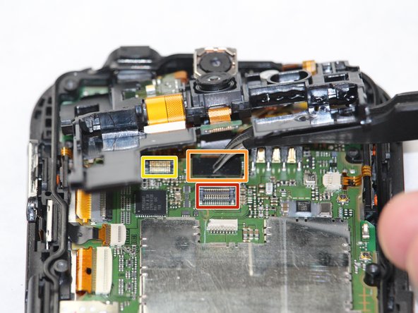

  3. Kyocera DuraForce Pro Camera Replacement: crwdns2935265:03crwdnd2935265:01crwdnd2935265:03crwdne2935265:0 Kyocera DuraForce Pro Camera Replacement: crwdns2935265:03crwdnd2935265:02crwdnd2935265:03crwdne2935265:0 Kyocera DuraForce Pro Camera Replacement: crwdns2935265:03crwdnd2935265:03crwdnd2935265:03crwdne2935265:0
    • Once the battery pops out, remove the orange tape that connects the battery to the phone.
    • Next, remove the 2 screws connecting the mounting bracket.
    • Remove mounting bracket.

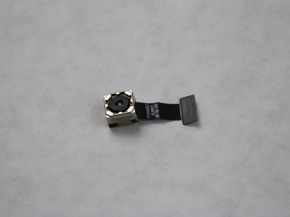

  4. Kyocera DuraForce Pro Camera Replacement: crwdns2935265:04crwdnd2935265:01crwdnd2935265:02crwdne2935265:0 Kyocera DuraForce Pro Camera Replacement: crwdns2935265:04crwdnd2935265:02crwdnd2935265:02crwdne2935265:0
    • Pull the camera housing out of the phone.
