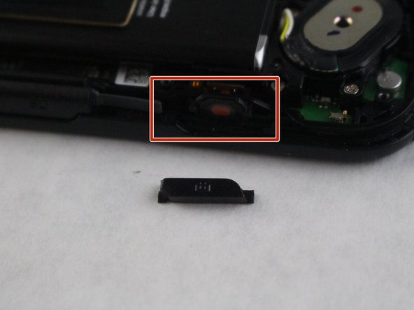

    • Flip phone on its back side.
    • Remove the outer case by using the plastic opening tool.
  2. Kyocera DuraForce Pro Camera Button Replacement: crwdns2935265:02crwdnd2935265:01crwdnd2935265:03crwdne2935265:0 Kyocera DuraForce Pro Camera Button Replacement: crwdns2935265:02crwdnd2935265:02crwdnd2935265:03crwdne2935265:0 Kyocera DuraForce Pro Camera Button Replacement: crwdns2935265:02crwdnd2935265:03crwdnd2935265:03crwdne2935265:0
    • Remove the 8 screws with a JIS #0 screwdriver.
    • Using the plastic opening tool, remove the cover that was being held in place by the screws.
  3. Kyocera DuraForce Pro Camera Button Replacement: crwdns2935265:03crwdnd2935265:01crwdnd2935265:02crwdne2935265:0 Kyocera DuraForce Pro Camera Button Replacement: crwdns2935265:03crwdnd2935265:02crwdnd2935265:02crwdne2935265:0
    • Once accessible, buttons around the edge of the phone can be removed. They may even fall out on their own.
