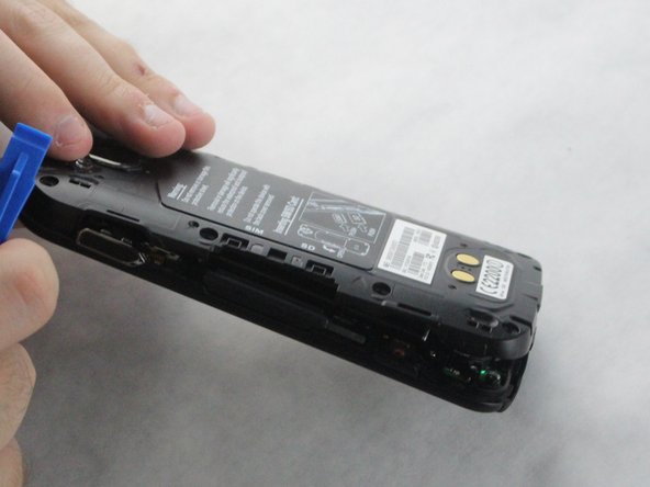

    • Be sure the device is turned off.
    • Flip the phone onto its backside.
    • Remove the back cover by using a plastic opening tool.

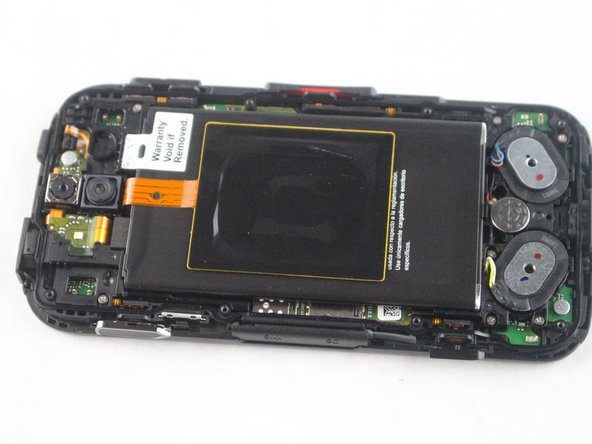

  2. Kyocera DuraForce Pro Battery Replacement: crwdns2935265:02crwdnd2935265:01crwdnd2935265:03crwdne2935265:0 Kyocera DuraForce Pro Battery Replacement: crwdns2935265:02crwdnd2935265:02crwdnd2935265:03crwdne2935265:0 Kyocera DuraForce Pro Battery Replacement: crwdns2935265:02crwdnd2935265:03crwdnd2935265:03crwdne2935265:0
    • Remove the eight screws with a JIS #0 screwdriver.

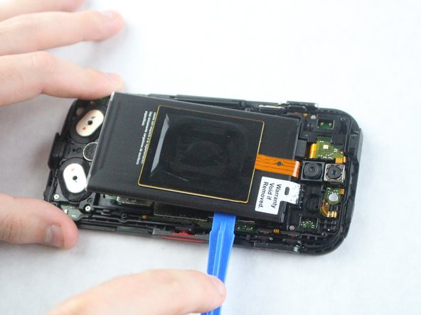

  3. Kyocera DuraForce Pro Battery Replacement: crwdns2935265:03crwdnd2935265:01crwdnd2935265:03crwdne2935265:0 Kyocera DuraForce Pro Battery Replacement: crwdns2935265:03crwdnd2935265:02crwdnd2935265:03crwdne2935265:0 Kyocera DuraForce Pro Battery Replacement: crwdns2935265:03crwdnd2935265:03crwdnd2935265:03crwdne2935265:0
    • Once the back cover is removed, the (6) buttons along the side are going to fall out of place.

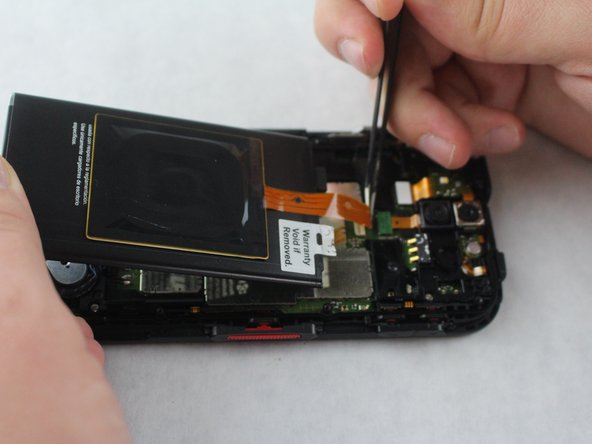

    • Using the plastic opening tool from earlier, lift the battery out by wedging it along the edge.
    • Using tweezers, unlock the ribbon cable port and lightly pull the cable upwards until it becomes unplugged.
