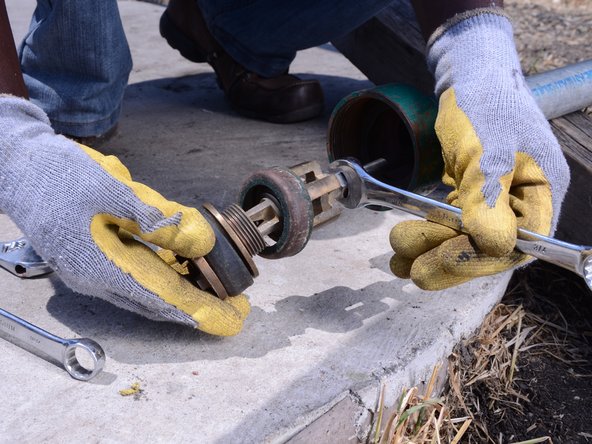

  36. Kutsiva Vharuvhu Yepamusoro Yepombi YeBush, Cylinder (Shona): crwdns2935265:036crwdnd2935265:01crwdnd2935265:01crwdne2935265:0
    • Iva nechokwadi kuti humburumbira haiende pasi kudzivirira hutachiona
  37. Kutsiva Vharuvhu Yepamusoro Yepombi YeBush: crwdns2935265:037crwdnd2935265:01crwdnd2935265:03crwdne2935265:0 Kutsiva Vharuvhu Yepamusoro Yepombi YeBush: crwdns2935265:037crwdnd2935265:02crwdnd2935265:03crwdne2935265:0 Kutsiva Vharuvhu Yepamusoro Yepombi YeBush: crwdns2935265:037crwdnd2935265:03crwdnd2935265:03crwdne2935265:0
    • Uchishandisa zvipanera zviviri zvepombi, sunungura humburumbira kubva papombi refu.
  38. Kutsiva Vharuvhu Yepamusoro Yepombi YeBush: crwdns2935265:038crwdnd2935265:01crwdnd2935265:02crwdne2935265:0 Kutsiva Vharuvhu Yepamusoro Yepombi YeBush: crwdns2935265:038crwdnd2935265:02crwdnd2935265:02crwdne2935265:0
    • Donza humburumbira yacho zvinyoronyoro kubva pamutanda wepombi, uchiisa pachena vharuvhu yekumusoro nevharuvhu yepasi pemugodhi wemvura.

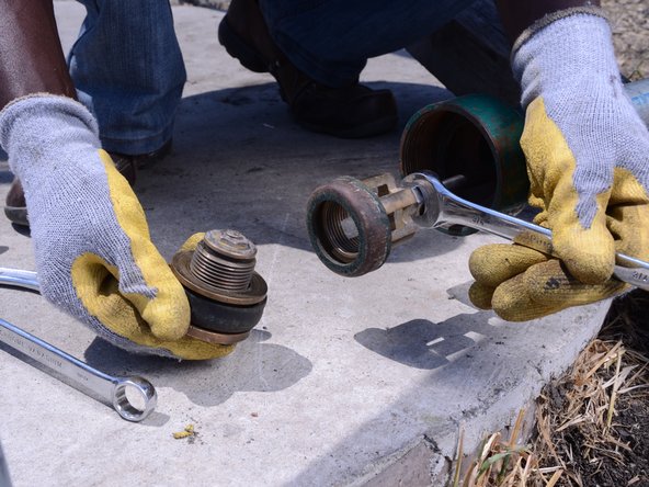

  39. Kutsiva Vharuvhu Yepamusoro Yepombi YeBush, Traveling Valve (Shona): crwdns2935265:039crwdnd2935265:01crwdnd2935265:03crwdne2935265:0 Kutsiva Vharuvhu Yepamusoro Yepombi YeBush, Traveling Valve (Shona): crwdns2935265:039crwdnd2935265:02crwdnd2935265:03crwdne2935265:0 Kutsiva Vharuvhu Yepamusoro Yepombi YeBush, Traveling Valve (Shona): crwdns2935265:039crwdnd2935265:03crwdnd2935265:03crwdne2935265:0
    • Uchishandisa zvipanera zviviri zvepombi, sunungura chivharo kubva pahumburumbira.
    • Uchishandisa chimwe chipanera kuti zvireruke, sunungura vharuvhu kubva pamutanda wepombi.
  40. Kutsiva Vharuvhu Yepamusoro Yepombi YeBush: crwdns2935265:040crwdnd2935265:01crwdnd2935265:02crwdne2935265:0 Kutsiva Vharuvhu Yepamusoro Yepombi YeBush: crwdns2935265:040crwdnd2935265:02crwdnd2935265:02crwdne2935265:0
    • Bvisa vharuvhu yepasi kubva pane chivharo.
  41. Kutsiva Vharuvhu Yepamusoro Yepombi YeBush: crwdns2935265:041crwdnd2935265:01crwdnd2935265:03crwdne2935265:0 Kutsiva Vharuvhu Yepamusoro Yepombi YeBush: crwdns2935265:041crwdnd2935265:02crwdnd2935265:03crwdne2935265:0 Kutsiva Vharuvhu Yepamusoro Yepombi YeBush: crwdns2935265:041crwdnd2935265:03crwdnd2935265:03crwdne2935265:0
    • Chenjerera kusachengeta nhengo dzevharuvhu dziri pasi.
    • Ongorora nhengo dzevharuvhu yepasi kuti hadzina kusakara here.
  42. Kutsiva Vharuvhu Yepamusoro Yepombi YeBush: crwdns2935265:042crwdnd2935265:01crwdnd2935265:02crwdne2935265:0 Kutsiva Vharuvhu Yepamusoro Yepombi YeBush: crwdns2935265:042crwdnd2935265:02crwdnd2935265:02crwdne2935265:0
    • Bvisa chekuvharisa kubva pavharuvhu kuti uongorore kusakara.
    • Ona kuti wanyatsotarisa marongerwo nekwakatarisa nhengo kuitira pakuzodzidzorera. Izvi zvinokosha, nekuti pombi haizoshanda kana vharuvhu isina kudzorerwa zvakanaka.
