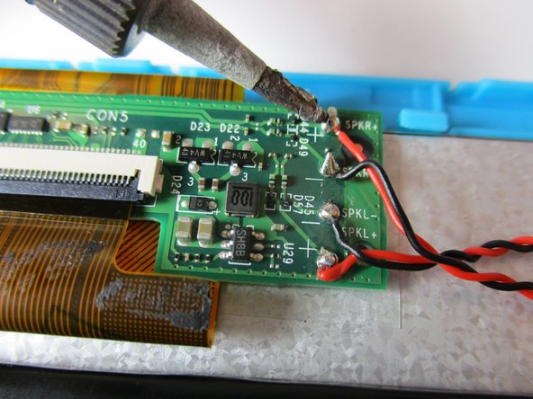

  4. Kurio Xtreme Speaker Replacement, Speaker: crwdns2935265:04crwdnd2935265:01crwdnd2935265:02crwdne2935265:0 Kurio Xtreme Speaker Replacement, Speaker: crwdns2935265:04crwdnd2935265:02crwdnd2935265:02crwdne2935265:0
    • Disconnect the 2 sets of black and red wires (4 wires total) from the motherboard by soldering the ends connected to the motherboard.
    • The soldering iron gets very hot and may injure you if exposed to your skin.
