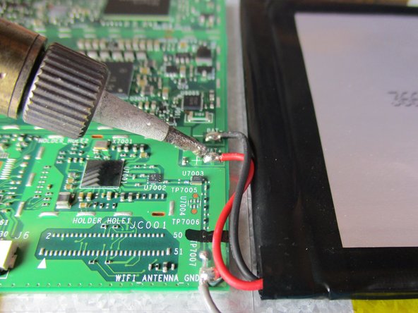

  4. Kurio Xtreme Battery Replacement, Battery: crwdns2935265:04crwdnd2935265:01crwdnd2935265:02crwdne2935265:0 Kurio Xtreme Battery Replacement, Battery: crwdns2935265:04crwdnd2935265:02crwdnd2935265:02crwdne2935265:0
    • Disconnect the black and red wires from the motherboard by soldering the ends that are connected to the motherboard.
    • The soldering iron gets very hot and may injure you if exposed to your skin.
