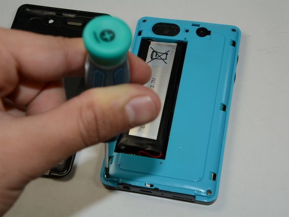

    • To remove the battery, make sure the four 5mm Philips screws on each side of your device is open using the Phillips #1 Screwdriver
    • After you remove your four 5mm Philips screws, use your plastic opening tool to help you open the plastic cover of your device.
  4. Kurio Touch 4S Speaker  Replacement: crwdns2935265:04crwdnd2935265:01crwdnd2935265:01crwdne2935265:0
