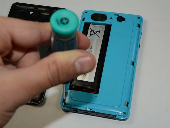

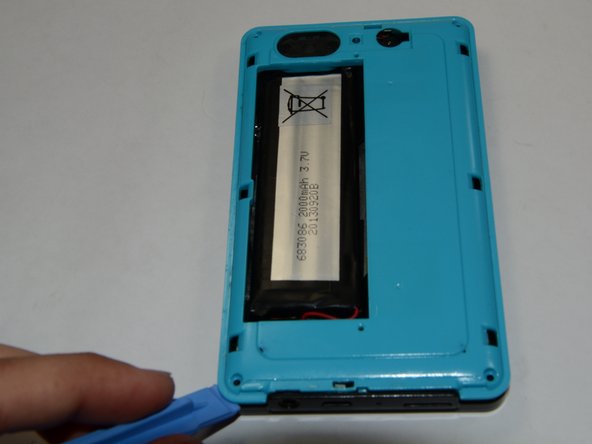

    • Make sure to open the back cover easily using the plastic opening tool
  2. Kurio Touch 4S Screen Replacement: crwdns2935265:02crwdnd2935265:01crwdnd2935265:03crwdne2935265:0 Kurio Touch 4S Screen Replacement: crwdns2935265:02crwdnd2935265:02crwdnd2935265:03crwdne2935265:0 Kurio Touch 4S Screen Replacement: crwdns2935265:02crwdnd2935265:03crwdnd2935265:03crwdne2935265:0
    • Remove back cover by prying away from the Kurio.
    • The easiest place to remove the cover is from the bottom and top; try to open it from right to left sides.

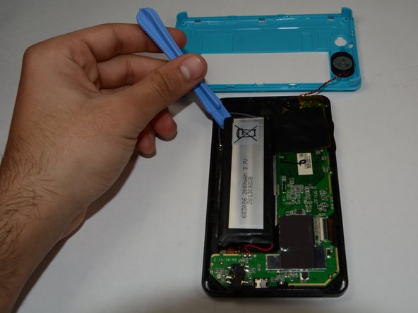

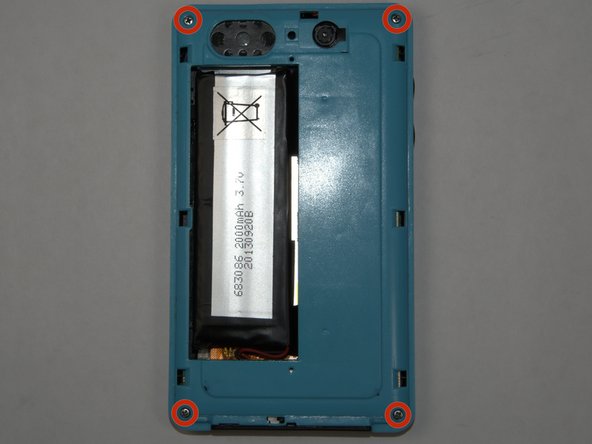

  3. Kurio Touch 4S Screen Replacement: crwdns2935265:03crwdnd2935265:01crwdnd2935265:02crwdne2935265:0 Kurio Touch 4S Screen Replacement: crwdns2935265:03crwdnd2935265:02crwdnd2935265:02crwdne2935265:0
    • To remove the battery, make sure the four 5mm Philips screws on each side of your device is open using the Philips#1 Screwdriver.
  4. Kurio Touch 4S Screen Replacement: crwdns2935265:04crwdnd2935265:01crwdnd2935265:01crwdne2935265:0
    • After you remove your four 5mm Phillips screws, use your plastic opening tool to help you open the plastic cover of your device.
    • All these screws are identical so don't worry if you get them out of order.

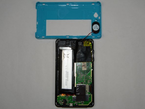

  5. Kurio Touch 4S Screen Replacement: crwdns2935265:05crwdnd2935265:01crwdnd2935265:01crwdne2935265:0
    • Remove the plastic cover that is covering the camera area.
  6. Kurio Touch 4S Screen Replacement: crwdns2935265:06crwdnd2935265:01crwdnd2935265:01crwdne2935265:0
    • Separate the two halves of your Kurio Touch 4S and lay them besides each other.

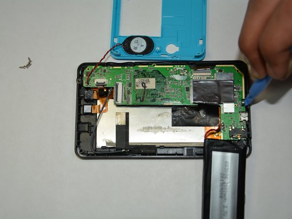

  7. Kurio Touch 4S Screen Replacement: crwdns2935265:07crwdnd2935265:01crwdnd2935265:01crwdne2935265:0
    • Use Phillips # 1 screw to open the 4 screws on the motherboard.
    • Open the screws gently and do not apply too much force as you could damage the motherboard.
  8. Kurio Touch 4S Screen Replacement: crwdns2935265:08crwdnd2935265:01crwdnd2935265:01crwdne2935265:0
    • Use the plastic opener to remove the battery.

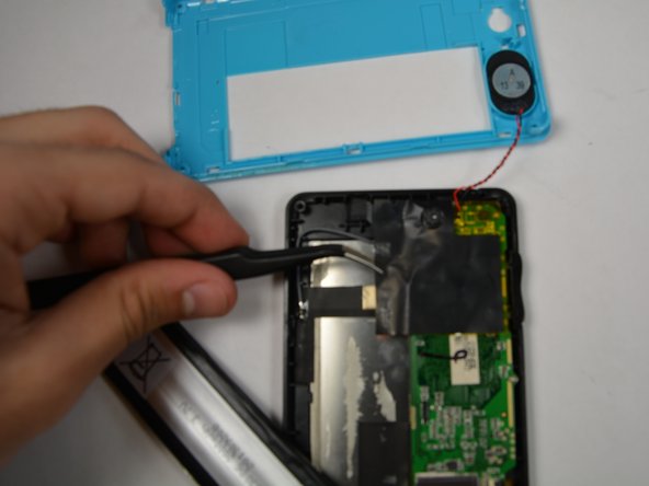

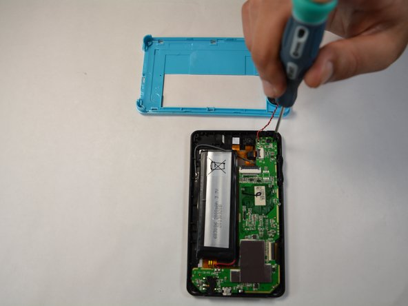

  9. Kurio Touch 4S Screen Replacement: crwdns2935265:09crwdnd2935265:01crwdnd2935265:01crwdne2935265:0
    • Use tweezers to remove the black tape that is attached to the motherboard.

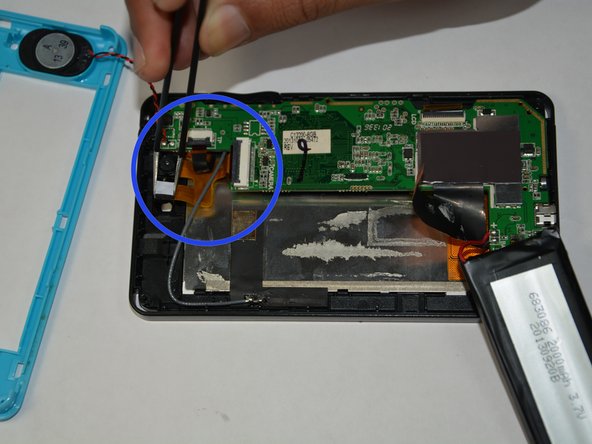

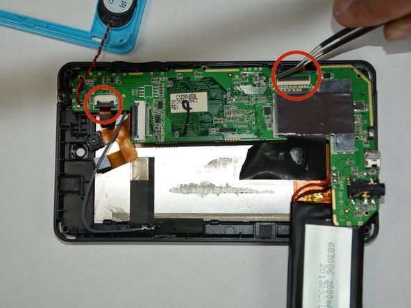

  10. Kurio Touch 4S Screen Replacement: crwdns2935265:010crwdnd2935265:01crwdnd2935265:02crwdne2935265:0 Kurio Touch 4S Screen Replacement: crwdns2935265:010crwdnd2935265:02crwdnd2935265:02crwdne2935265:0
    • Detach all the wire that are connected to the motherboard.
    • Also remove the camera module and other components that are attached to the motherboard.
    • For more information on soldering Click here

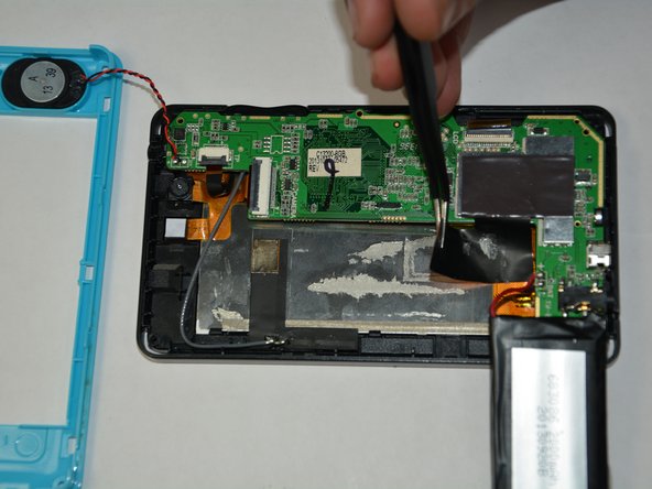

  11. Kurio Touch 4S Screen Replacement: crwdns2935265:011crwdnd2935265:01crwdnd2935265:01crwdne2935265:0
    • Remove the motherboard with the help of plastic opener.
    • Detach the power plug before you remove the motherboard.

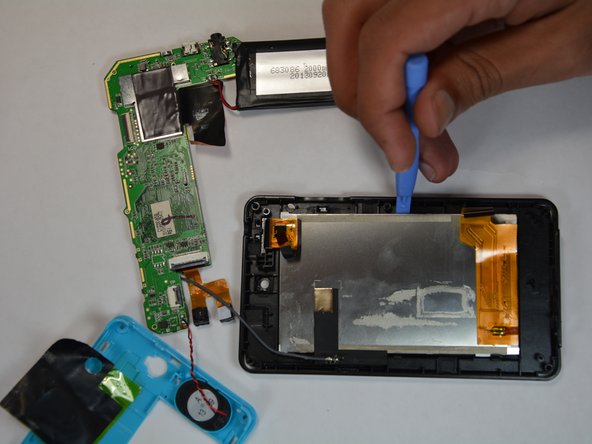

  12. Kurio Touch 4S Screen Replacement: crwdns2935265:012crwdnd2935265:01crwdnd2935265:01crwdne2935265:0
    • Use the Plastic opener to remove the screen.
    • Do not apply too much pressure as the front cover could be damaged.

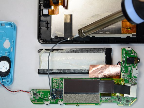

  13. Kurio Touch 4S Screen Replacement: crwdns2935265:013crwdnd2935265:01crwdnd2935265:01crwdne2935265:0
    • Use the soldering tool to remove the wire that is attached to the screen & the motherboard.
  14. Kurio Touch 4S Screen Replacement: crwdns2935265:014crwdnd2935265:01crwdnd2935265:01crwdne2935265:0
    • Use tweezers to remove the screen from your Kurio Toich 4S.
