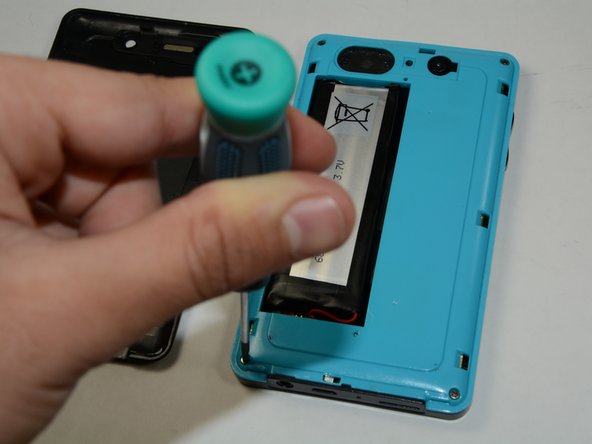

    • To remove the battery, make sure the four 5mm Phillips screws on each side of your device is open using the Phillips #1 Screwdriver
    • After you remove your four 5mm Phillips screws, use your plastic opening tool to help you open the plastic cover of your device.

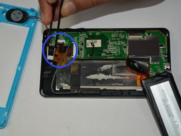

    • Use tweezers to remove the black tape that is attached to the motherboard.
  10. Kurio Touch 4S Power Button Replacement: crwdns2935265:010crwdnd2935265:01crwdnd2935265:02crwdne2935265:0 Kurio Touch 4S Power Button Replacement: crwdns2935265:010crwdnd2935265:02crwdnd2935265:02crwdne2935265:0
    • Detach all the wire that are connected to the motherboard.
    • Detach the camera module and other components that are attached to the motherboard.
