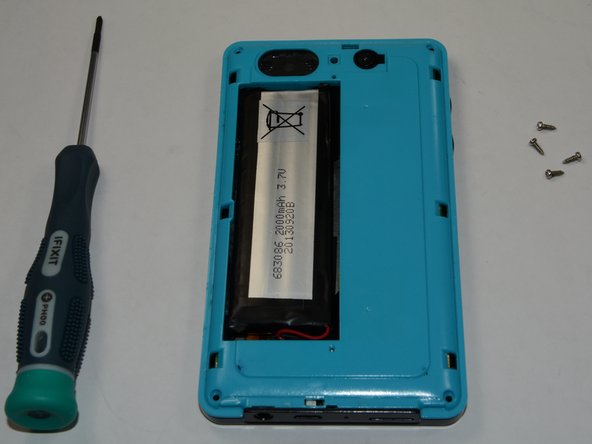

    • Make sure to open the back cover easily using the plastic opening tool.
  2. Kurio Touch 4S Front & Rear Facing Cameras Replacement: crwdns2935265:02crwdnd2935265:01crwdnd2935265:03crwdne2935265:0 Kurio Touch 4S Front & Rear Facing Cameras Replacement: crwdns2935265:02crwdnd2935265:02crwdnd2935265:03crwdne2935265:0 Kurio Touch 4S Front & Rear Facing Cameras Replacement: crwdns2935265:02crwdnd2935265:03crwdnd2935265:03crwdne2935265:0

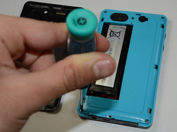

    • Remove back cover by prying away from the Kurio.
    • The easiest place to remove the cover is from the bottom and top; try to open it from right to left sides.
  3. Kurio Touch 4S Front & Rear Facing Cameras Replacement: crwdns2935265:03crwdnd2935265:01crwdnd2935265:03crwdne2935265:0 Kurio Touch 4S Front & Rear Facing Cameras Replacement: crwdns2935265:03crwdnd2935265:02crwdnd2935265:03crwdne2935265:0 Kurio Touch 4S Front & Rear Facing Cameras Replacement: crwdns2935265:03crwdnd2935265:03crwdnd2935265:03crwdne2935265:0
    • To remove the battery, make sure the four 5mm Philips screws on each side of your device is open using the philips#1 Screwdriver.
  4. Kurio Touch 4S Front & Rear Facing Cameras Replacement: crwdns2935265:04crwdnd2935265:01crwdnd2935265:01crwdne2935265:0
    • After you remove your four 5mm Philips screws, use your plastic opening tool to help you open the plastic cover of your device.
    • All these screws are identical so don't worry if you miss them up.

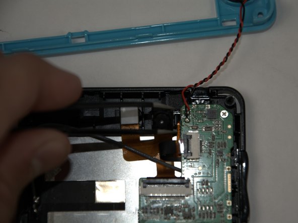

  5. Kurio Touch 4S Front & Rear Facing Cameras Replacement: crwdns2935265:05crwdnd2935265:01crwdnd2935265:01crwdne2935265:0
    • Remove the battery because it blocks the plastic shield that covers the camera.
    • Do not remove the wires that are attached to the battery and the motherboard.
  6. Kurio Touch 4S Front & Rear Facing Cameras Replacement: crwdns2935265:06crwdnd2935265:01crwdnd2935265:01crwdne2935265:0
    • Remove the plastic cover that is covering the camera area using tweezers.

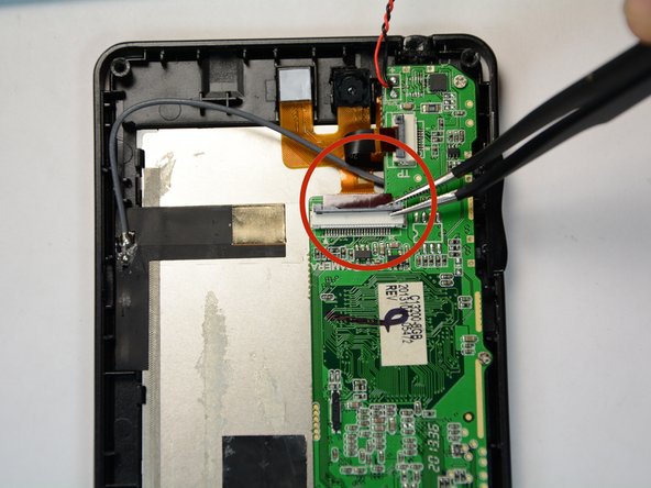

  8. Kurio Touch 4S Front & Rear Facing Cameras Replacement: crwdns2935265:08crwdnd2935265:01crwdnd2935265:02crwdne2935265:0 Kurio Touch 4S Front & Rear Facing Cameras Replacement: crwdns2935265:08crwdnd2935265:02crwdnd2935265:02crwdne2935265:0
    • Remove the copper wires by using the Tweezers to replace your new camera.
