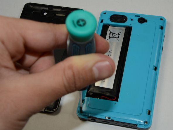

    • Make sure to open the back cover easily using the plastic opening tool.
  2. Kurio Touch 4S Battery Replacement: crwdns2935265:02crwdnd2935265:01crwdnd2935265:03crwdne2935265:0 Kurio Touch 4S Battery Replacement: crwdns2935265:02crwdnd2935265:02crwdnd2935265:03crwdne2935265:0 Kurio Touch 4S Battery Replacement: crwdns2935265:02crwdnd2935265:03crwdnd2935265:03crwdne2935265:0
    • Remove back cover by prying away from the device.
    • The easiest place to remove the cover is from the bottom and top, then try to open it from the right and left sides.
    • Open it gently. Do not open it with too much pressure, so that the plastic back cover do not break.
  3. Kurio Touch 4S Battery Replacement: crwdns2935265:03crwdnd2935265:01crwdnd2935265:03crwdne2935265:0 Kurio Touch 4S Battery Replacement: crwdns2935265:03crwdnd2935265:02crwdnd2935265:03crwdne2935265:0 Kurio Touch 4S Battery Replacement: crwdns2935265:03crwdnd2935265:03crwdnd2935265:03crwdne2935265:0

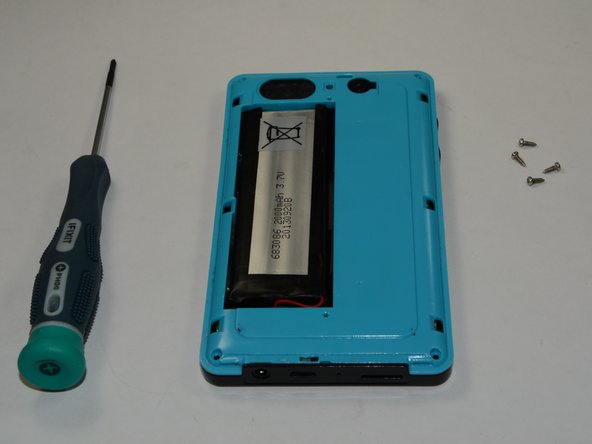

    • To remove the battery, make sure the four 5mm Philips screws on each side of your device is open using the Phillips #1 Screwdriver.
  4. Kurio Touch 4S Battery Replacement: crwdns2935265:04crwdnd2935265:01crwdnd2935265:01crwdne2935265:0
    • After you remove your four screws use your plastic opening tool to help you open the plastic cover of your device.
  5. Kurio Touch 4S Battery Replacement: crwdns2935265:05crwdnd2935265:01crwdnd2935265:01crwdne2935265:0
    • Use the plastic opening tool to remove the battery from its place.
    • The battery is glued into the device. So try removing it gently.
  6. Kurio Touch 4S Battery Replacement: crwdns2935265:06crwdnd2935265:01crwdnd2935265:01crwdne2935265:0
    • Remove the two wires using soldering tool to detach your bad battery from the device .
    • Gently remove the wires one by one. Do not damage the head that is glued into the motherboard.
