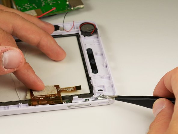

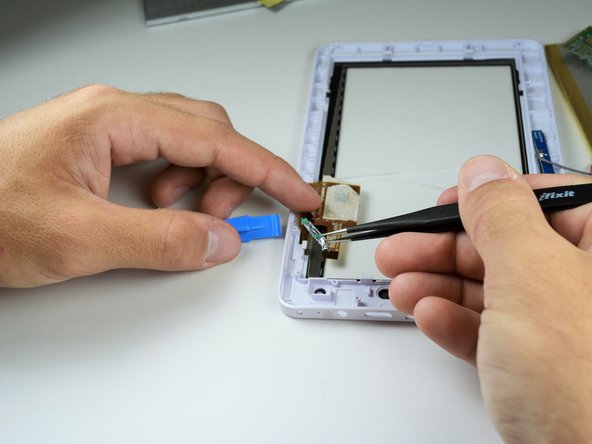

  13. Kurio 7 Volume/ Power Button Replacement, Volume/ Power Button: crwdns2935265:013crwdnd2935265:01crwdnd2935265:02crwdne2935265:0 Kurio 7 Volume/ Power Button Replacement, Volume/ Power Button: crwdns2935265:013crwdnd2935265:02crwdnd2935265:02crwdne2935265:0
    • Locate the volume button. It will be located at the corner adjacent to the speaker.
    • Pull out the detached power key.
  14. Kurio 7 Volume/ Power Button Replacement: crwdns2935265:014crwdnd2935265:01crwdnd2935265:02crwdne2935265:0 Kurio 7 Volume/ Power Button Replacement: crwdns2935265:014crwdnd2935265:02crwdnd2935265:02crwdne2935265:0
    • Remove volume button by using the opening tool to push inward from the outside while pulling on it from the inside using the tweezers.
    • Don't be afraid to press hard with the opening tool. Extra force may be needed to remove the volume button.
Inserting the replacement part may be tricky. Do not force the new part in, as it may break. To reassemble your device, follow these instructions in reverse order.
