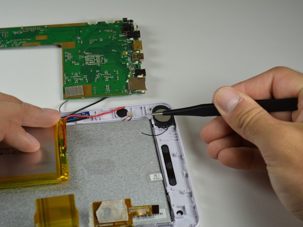

  10. Kurio 7 Speaker Replacement, Speaker: crwdns2935265:010crwdnd2935265:01crwdnd2935265:01crwdne2935265:0
    • Pull the wires off of the motherboard using the tweezers. The wires aren't soldered on well.
    • Before you do break the solder, check the wires connections. You may be able to just solder the wire if it is already broken off.
  11. Kurio 7 Speaker Replacement: crwdns2935265:011crwdnd2935265:01crwdnd2935265:02crwdne2935265:0 Kurio 7 Speaker Replacement: crwdns2935265:011crwdnd2935265:02crwdnd2935265:02crwdne2935265:0

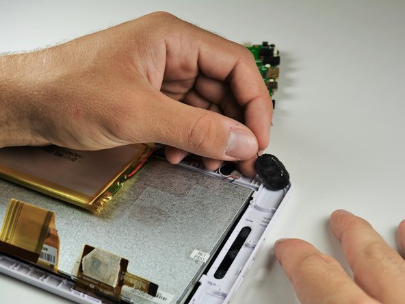

  12. Kurio 7 Speaker Replacement: crwdns2935265:012crwdnd2935265:01crwdnd2935265:03crwdne2935265:0 Kurio 7 Speaker Replacement: crwdns2935265:012crwdnd2935265:02crwdnd2935265:03crwdne2935265:0 Kurio 7 Speaker Replacement: crwdns2935265:012crwdnd2935265:03crwdnd2935265:03crwdne2935265:0
    • Use the spudger to pry out the old speaker.
    • You have successfully removed the speaker!
Solder in the new speaker. Refer to the soldering guide if you're unsure on how to solder. To reassemble your device, follow these instructions in reverse order.
