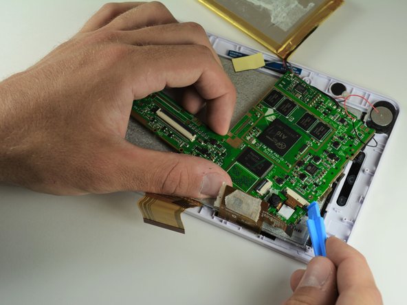

  8. Kurio 7 Camera Replacement: crwdns2935265:08crwdnd2935265:01crwdnd2935265:01crwdne2935265:0
    • There should be masking tape on the yellow ribbon. Pull the tape off of the motherboard and wrap it around the yellow ribbon.
    • Do not pull the tape completely off the motherboard, as it is used to protect components on the ribbon.
    • To remove the ribbon from the mount, follow the same steps in Step 3.
  9. Kurio 7 Camera Replacement: crwdns2935265:09crwdnd2935265:01crwdnd2935265:01crwdne2935265:0
    • Pull back the ribbons and put the battery near the bottom of the Kurio.
    • The motherboard is now removed so that other components can be worked on.

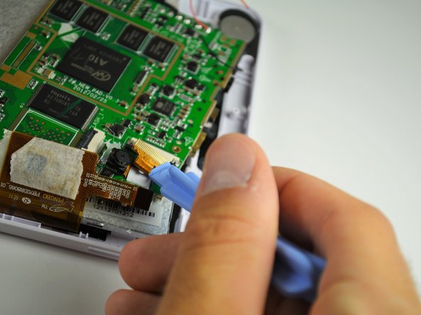

  11. Kurio 7 Camera Replacement: crwdns2935265:011crwdnd2935265:01crwdnd2935265:03crwdne2935265:0 Kurio 7 Camera Replacement: crwdns2935265:011crwdnd2935265:02crwdnd2935265:03crwdne2935265:0 Kurio 7 Camera Replacement: crwdns2935265:011crwdnd2935265:03crwdnd2935265:03crwdne2935265:0
    • To release the camera's ribbon, use the opening tool to pull on the black edges of the ribbon mount.
    • Alternate sides until the ribbon is loose enough to pull out.
