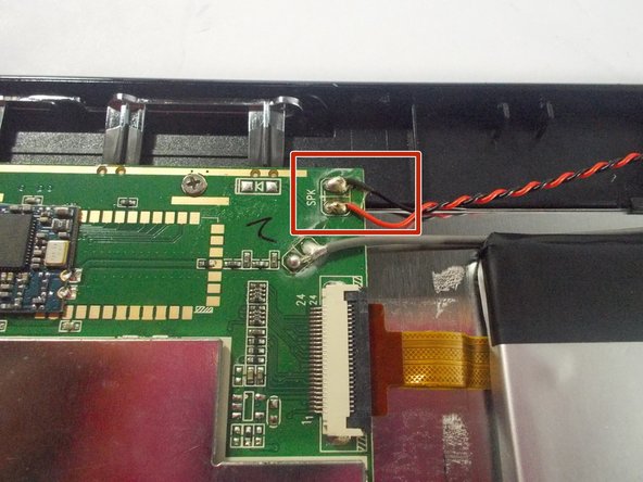

  6. Kurio 10S Speakers Replacement: crwdns2935265:06crwdnd2935265:01crwdnd2935265:02crwdne2935265:0 Kurio 10S Speakers Replacement: crwdns2935265:06crwdnd2935265:02crwdnd2935265:02crwdne2935265:0
    • Use a soldering iron to desolder the black and red wire speaker wires from the motherboard.
    • Motherboard parts are very fragile, so be careful when removing the wires
  7. Kurio 10S Speakers Replacement: crwdns2935265:07crwdnd2935265:01crwdnd2935265:01crwdne2935265:0
    • Remove the speaker from its holder.
