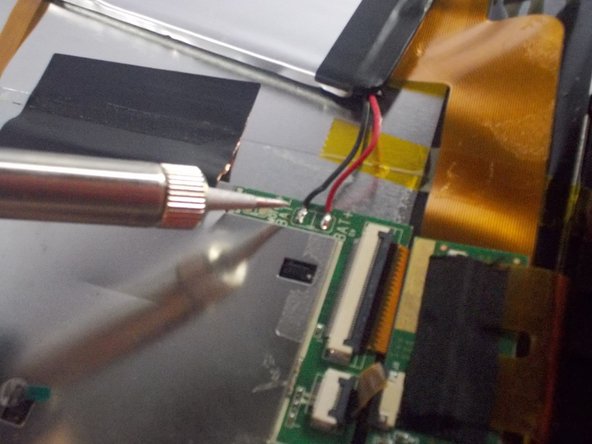

  6. Kurio 10S Motherboard Replacement: crwdns2935265:06crwdnd2935265:01crwdnd2935265:02crwdne2935265:0 Kurio 10S Motherboard Replacement: crwdns2935265:06crwdnd2935265:02crwdnd2935265:02crwdne2935265:0
    • Locate the red and black wire connections where the battery is connected to the motherboard.
    • Now remove the red and black wires by soldering the ends of the wires off where they connect to the motherboard.

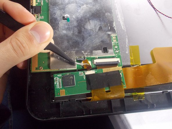

  7. Kurio 10S Motherboard Replacement: crwdns2935265:07crwdnd2935265:01crwdnd2935265:01crwdne2935265:0
    • Locate and remove the copper tape connecting the motherboard to the back of the screen

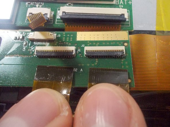

  8. Kurio 10S Motherboard Replacement: crwdns2935265:08crwdnd2935265:01crwdnd2935265:03crwdne2935265:0 Kurio 10S Motherboard Replacement: crwdns2935265:08crwdnd2935265:02crwdnd2935265:03crwdne2935265:0 Kurio 10S Motherboard Replacement: crwdns2935265:08crwdnd2935265:03crwdnd2935265:03crwdne2935265:0
    • Locate the ribbon cables connecting the motherboard to the screen and other peripherals.
    • Carefully lift the black part of the cable connector on the motherboard and pull the cable from the connector.
