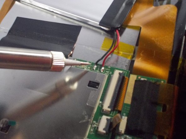

  7. Kurio 10S Battery Replacement: crwdns2935265:07crwdnd2935265:01crwdnd2935265:02crwdne2935265:0 Kurio 10S Battery Replacement: crwdns2935265:07crwdnd2935265:02crwdnd2935265:02crwdne2935265:0
    • Locate the red and black wire connections where the battery is connected to the motherboard.
    • Now remove the red and black wires by soldering the ends of the wires off where they connect to the motherboard.
    • Caution: Soldering irons run hot. When removing solder from the board, the iron heats up the components, so be careful when using one.
