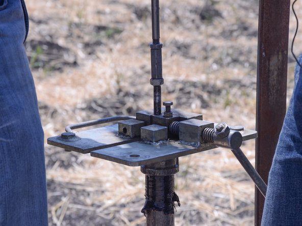

    • Bvisa mapini maviri akabatanidza mubato nechinofambisa mubato.
  3. Kugadzira vharuvhu Yepasi Yepombi Yekudhonza Mvura: crwdns2935265:03crwdnd2935265:01crwdnd2935265:02crwdne2935265:0 Kugadzira vharuvhu Yepasi Yepombi Yekudhonza Mvura: crwdns2935265:03crwdnd2935265:02crwdnd2935265:02crwdne2935265:0
    • Dhonza mibato miviri kubva kune chinofambisa mubato.
  4. Kugadzira vharuvhu Yepasi Yepombi Yekudhonza Mvura: crwdns2935265:04crwdnd2935265:01crwdnd2935265:02crwdne2935265:0 Kugadzira vharuvhu Yepasi Yepombi Yekudhonza Mvura: crwdns2935265:04crwdnd2935265:02crwdnd2935265:02crwdne2935265:0
    • Simudza mapini maviri akabatanidza pombi kumusoro nemubato, kubva papombi.
  5. Kugadzira vharuvhu Yepasi Yepombi Yekudhonza Mvura: crwdns2935265:05crwdnd2935265:01crwdnd2935265:03crwdne2935265:0 Kugadzira vharuvhu Yepasi Yepombi Yekudhonza Mvura: crwdns2935265:05crwdnd2935265:02crwdnd2935265:03crwdne2935265:0 Kugadzira vharuvhu Yepasi Yepombi Yekudhonza Mvura: crwdns2935265:05crwdnd2935265:03crwdnd2935265:03crwdne2935265:0
    • Mudanho rino rose, ona kuti watsigira mubato nemusoro nemaoko matatu kana kupfuura.
    • Buritsa chimutanda chejoinhi kubva muchimusoro.
    • Wongorora chimutanda chejoinhi nemusoro kuti hazvina kusakara kana kukuvara here.

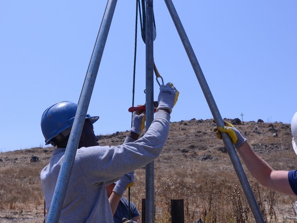

    • Pombi iyi inoshandisa chinotsigira chine makumbo matatu (tiraipodhi) pamwe nezvinodhonza netambo kusimudza pombi refu. Zvipanera zvakaita saC zvinogona kushandiswawo kusimudza pombi refu
    • Nyatsosunga zvakanaka chinosimudzira pombi yemvura kumubato mukuru pasi pemuromo.
  19. Kugadzira vharuvhu Yepasi Yepombi Yekudhonza Mvura: crwdns2935265:019crwdnd2935265:01crwdnd2935265:02crwdne2935265:0 Kugadzira vharuvhu Yepasi Yepombi Yekudhonza Mvura: crwdns2935265:019crwdnd2935265:02crwdnd2935265:02crwdne2935265:0

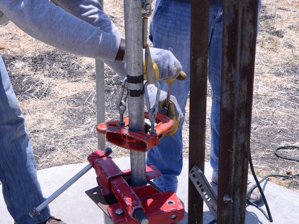

    • Wakachenjerera kuti tambo isatsvedze, shandisa zvinodhonza mubato netambo kusimudza pombi refu kusvikira zvinosimudza pombi zvasvika pane zvinodhonza netambo.
  20. Kugadzira vharuvhu Yepasi Yepombi Yekudhonza Mvura: crwdns2935265:020crwdnd2935265:01crwdnd2935265:03crwdne2935265:0 Kugadzira vharuvhu Yepasi Yepombi Yekudhonza Mvura: crwdns2935265:020crwdnd2935265:02crwdnd2935265:03crwdne2935265:0 Kugadzira vharuvhu Yepasi Yepombi Yekudhonza Mvura: crwdns2935265:020crwdnd2935265:03crwdnd2935265:03crwdne2935265:0

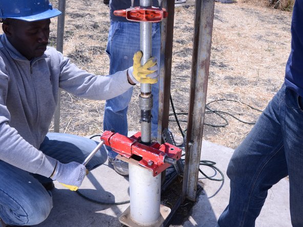

    • Kana pombi refu yasvika pane zvinodhonza netambo, sunga simbi inosunga nechepasi papombi refu
  21. Kugadzira vharuvhu Yepasi Yepombi Yekudhonza Mvura: crwdns2935265:021crwdnd2935265:01crwdnd2935265:03crwdne2935265:0 Kugadzira vharuvhu Yepasi Yepombi Yekudhonza Mvura: crwdns2935265:021crwdnd2935265:02crwdnd2935265:03crwdne2935265:0 Kugadzira vharuvhu Yepasi Yepombi Yekudhonza Mvura: crwdns2935265:021crwdnd2935265:03crwdnd2935265:03crwdne2935265:0
    • Batisa simbi inosungiswa pasi kumubato uchishandisa bhaudhi.
    • Bhaudhi rimwechete kazhinji rakakwana kuchengetedza simbi inosungiswa pasi panzvimbo, asi unogona kushandisa rimwe bhaudhi kana uchida kunyatsochisimbisa.
  22. Kugadzira vharuvhu Yepasi Yepombi Yekudhonza Mvura: crwdns2935265:022crwdnd2935265:01crwdnd2935265:03crwdne2935265:0 Kugadzira vharuvhu Yepasi Yepombi Yekudhonza Mvura: crwdns2935265:022crwdnd2935265:02crwdnd2935265:03crwdne2935265:0 Kugadzira vharuvhu Yepasi Yepombi Yekudhonza Mvura: crwdns2935265:022crwdnd2935265:03crwdnd2935265:03crwdne2935265:0
    • Wakatsigira pamusoro pepombi, nyatsofambisa chinosunga chinosimudza kubva papombi.
    • Dzikisa chinosunga chinosimudza pombi uchidzvanya nechepasi kuti tambo dzisasungane pane zvinodhonza.
  23. Kugadzira vharuvhu Yepasi Yepombi Yekudhonza Mvura: crwdns2935265:023crwdnd2935265:01crwdnd2935265:03crwdne2935265:0 Kugadzira vharuvhu Yepasi Yepombi Yekudhonza Mvura: crwdns2935265:023crwdnd2935265:02crwdnd2935265:03crwdne2935265:0 Kugadzira vharuvhu Yepasi Yepombi Yekudhonza Mvura: crwdns2935265:023crwdnd2935265:03crwdnd2935265:03crwdne2935265:0
    • Isa nekusunga chinosunga chekusimudzisa kumubato unosimudza pombi kusvika pasi pasi.

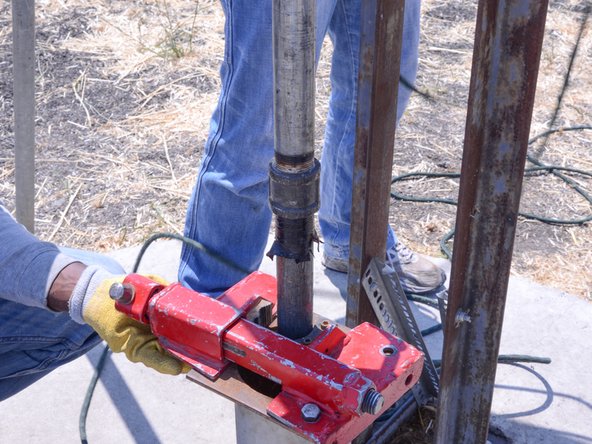

    • Uchishandisa chipanera, sunungura chidimbu chekutanga chepombi refu kubva pachakabata.
  30. Kugadzira vharuvhu Yepasi Yepombi Yekudhonza Mvura: crwdns2935265:030crwdnd2935265:01crwdnd2935265:03crwdne2935265:0 Kugadzira vharuvhu Yepasi Yepombi Yekudhonza Mvura: crwdns2935265:030crwdnd2935265:02crwdnd2935265:03crwdne2935265:0 Kugadzira vharuvhu Yepasi Yepombi Yekudhonza Mvura: crwdns2935265:030crwdnd2935265:03crwdnd2935265:03crwdne2935265:0
    • Nyatsovhara pajoinhi kuti mvura isapfachuke kubva nepanobatana simbi kana dzapatsanurwa.
    • Uchishandisa chipanera, sunungura pombi refu kusvikira mvura yatanga kupfachuka ichimwaya kupinda mune chinodzivisa mvura kupfachuka.
    • Usarambe uchisunungura kupfuura ipapo kusvikira mvura yamira kupfachuka.
  31. Kugadzira vharuvhu Yepasi Yepombi Yekudhonza Mvura: crwdns2935265:031crwdnd2935265:01crwdnd2935265:03crwdne2935265:0 Kugadzira vharuvhu Yepasi Yepombi Yekudhonza Mvura: crwdns2935265:031crwdnd2935265:02crwdnd2935265:03crwdne2935265:0 Kugadzira vharuvhu Yepasi Yepombi Yekudhonza Mvura: crwdns2935265:031crwdnd2935265:03crwdnd2935265:03crwdne2935265:0

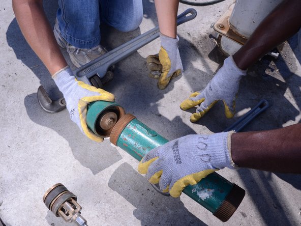

    • Bvisa chinovhara mvura kuti isapfachuke, wopedzisa kusunungura pombi refu.
    • Bvisa chidimbu chekutanga chepombi refu nekuchisimudza chakamira mudenga, wakachitsigira pamusoro pechidimbu chacho uye uchiramba wakachiisa mugomba rinochitsigira pamusoro petiraipodhi.
  32. Kugadzira vharuvhu Yepasi Yepombi Yekudhonza Mvura: crwdns2935265:032crwdnd2935265:01crwdnd2935265:03crwdne2935265:0 Kugadzira vharuvhu Yepasi Yepombi Yekudhonza Mvura: crwdns2935265:032crwdnd2935265:02crwdnd2935265:03crwdne2935265:0 Kugadzira vharuvhu Yepasi Yepombi Yekudhonza Mvura: crwdns2935265:032crwdnd2935265:03crwdnd2935265:03crwdne2935265:0

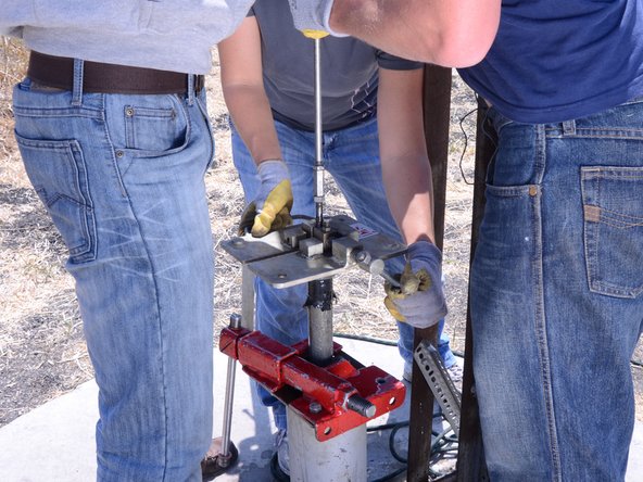

    • Kochekera nekusunga chekusungisa mutanda mainjisi mashoma pazasi pepanobatana mutanda wepombi wekutanga.
  33. Kugadzira vharuvhu Yepasi Yepombi Yekudhonza Mvura: crwdns2935265:033crwdnd2935265:01crwdnd2935265:03crwdne2935265:0 Kugadzira vharuvhu Yepasi Yepombi Yekudhonza Mvura: crwdns2935265:033crwdnd2935265:02crwdnd2935265:03crwdne2935265:0 Kugadzira vharuvhu Yepasi Yepombi Yekudhonza Mvura: crwdns2935265:033crwdnd2935265:03crwdnd2935265:03crwdne2935265:0
    • Uchishandisa chipanera chinokwana pakawanda, sunungura mutanda wepombi kubva pachikamu chasara.
    • Kana joinhi raganurwa, nyatsodzikisa pombi refu pasi.
  34. Kugadzira vharuvhu Yepasi Yepombi Yekudhonza Mvura: crwdns2935265:034crwdnd2935265:01crwdnd2935265:03crwdne2935265:0 Kugadzira vharuvhu Yepasi Yepombi Yekudhonza Mvura: crwdns2935265:034crwdnd2935265:02crwdnd2935265:03crwdne2935265:0 Kugadzira vharuvhu Yepasi Yepombi Yekudhonza Mvura: crwdns2935265:034crwdnd2935265:03crwdnd2935265:03crwdne2935265:0
    • Nyatsodzikisa pombi refu, yakatambarara, woiisa panzvimbo isina hutachiona, kana zvichigona zvakagara panzvimbo yakakwirira kudzivirira kubata hutachiona.
  35. Kugadzira vharuvhu Yepasi Yepombi Yekudhonza Mvura: crwdns2935265:035crwdnd2935265:01crwdnd2935265:03crwdne2935265:0 Kugadzira vharuvhu Yepasi Yepombi Yekudhonza Mvura: crwdns2935265:035crwdnd2935265:02crwdnd2935265:03crwdne2935265:0 Kugadzira vharuvhu Yepasi Yepombi Yekudhonza Mvura: crwdns2935265:035crwdnd2935265:03crwdnd2935265:03crwdne2935265:0
    • Bvisa mubato wakaita saT kubva mutanda wepombi waganurwa.
    • Kochekera mubato wakaita saT kumutanda wepombi wasara.
    • Bvisa simbi inosungiswa kubva papombi refu, wodzokorora matanho kubva pamakumi maviri nepfumbamwe kusvika makumi matatu neshanu kusvikira pombi refu yabva yose, kana kuti kusvika chikamu chakadamburwa chasvikwa.

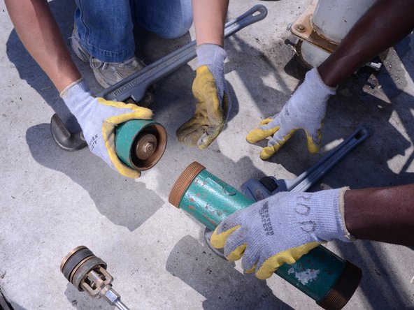

  36. Kugadzira vharuvhu Yepasi Yepombi Yekudhonza Mvura, Cylinder (Shona): crwdns2935265:036crwdnd2935265:01crwdnd2935265:01crwdne2935265:0
    • Iva nechokwadi kuti humburumbira haiende pasi kudzivirira hutachiona
  37. Kugadzira vharuvhu Yepasi Yepombi Yekudhonza Mvura: crwdns2935265:037crwdnd2935265:01crwdnd2935265:03crwdne2935265:0 Kugadzira vharuvhu Yepasi Yepombi Yekudhonza Mvura: crwdns2935265:037crwdnd2935265:02crwdnd2935265:03crwdne2935265:0 Kugadzira vharuvhu Yepasi Yepombi Yekudhonza Mvura: crwdns2935265:037crwdnd2935265:03crwdnd2935265:03crwdne2935265:0
    • Uchishandisa zvipanera zviviri zvepombi, sunungura humburumbira kubva papombi refu.
  38. Kugadzira vharuvhu Yepasi Yepombi Yekudhonza Mvura: crwdns2935265:038crwdnd2935265:01crwdnd2935265:02crwdne2935265:0 Kugadzira vharuvhu Yepasi Yepombi Yekudhonza Mvura: crwdns2935265:038crwdnd2935265:02crwdnd2935265:02crwdne2935265:0
    • Donza humburumbira yacho zvinyoronyoro kubva pamutanda wepombi, uchiisa pachena vharuvhu yekumusoro nevharuvhu yepasi pemugodhi wemvura.

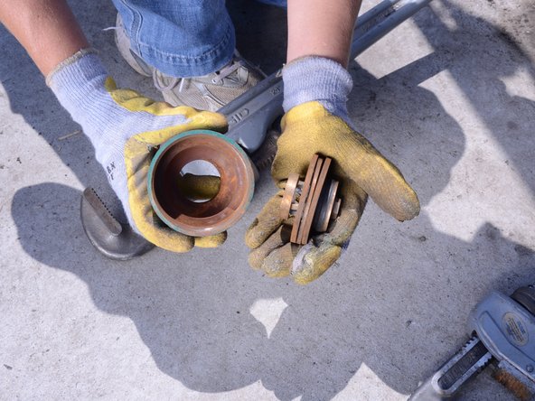

  39. Kugadzira vharuvhu Yepasi Yepombi Yekudhonza Mvura, Foot Valve (Shona): crwdns2935265:039crwdnd2935265:01crwdnd2935265:03crwdne2935265:0 Kugadzira vharuvhu Yepasi Yepombi Yekudhonza Mvura, Foot Valve (Shona): crwdns2935265:039crwdnd2935265:02crwdnd2935265:03crwdne2935265:0 Kugadzira vharuvhu Yepasi Yepombi Yekudhonza Mvura, Foot Valve (Shona): crwdns2935265:039crwdnd2935265:03crwdnd2935265:03crwdne2935265:0
    • Uchishandisa zvipanera zviviri zvepombi, sunungura chivharo kubva pahumburumbira.
  40. Kugadzira vharuvhu Yepasi Yepombi Yekudhonza Mvura: crwdns2935265:040crwdnd2935265:01crwdnd2935265:02crwdne2935265:0 Kugadzira vharuvhu Yepasi Yepombi Yekudhonza Mvura: crwdns2935265:040crwdnd2935265:02crwdnd2935265:02crwdne2935265:0

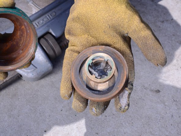

    • Bvisa vharuvhu yepasi kubva pane chivharo.
    • Nyatsotarisa kuti vharuvhu yepasi yakatarisa kupi muchivharo. Izvi zvakanyanya kukosha kuitira pakuzosunganidza zvose, nekuti pombi haizoshanda kana vharuvhu yakatarisa kusiri iko.
  41. Kugadzira vharuvhu Yepasi Yepombi Yekudhonza Mvura: crwdns2935265:041crwdnd2935265:01crwdnd2935265:02crwdne2935265:0 Kugadzira vharuvhu Yepasi Yepombi Yekudhonza Mvura: crwdns2935265:041crwdnd2935265:02crwdnd2935265:02crwdne2935265:0
    • Ongorora nhengo dzevharuvhu yepasi kuti hadzina kusakara here.
