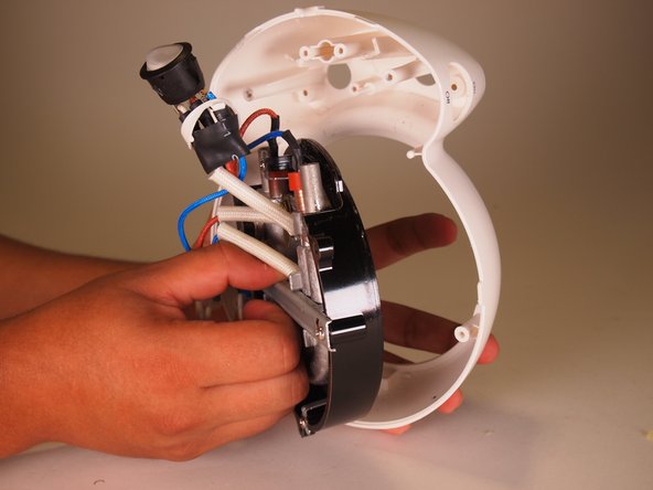

    • Using the Phillips #1 screwdriver, remove the three 15.8 mm screws to release the inner components from the plastic base.

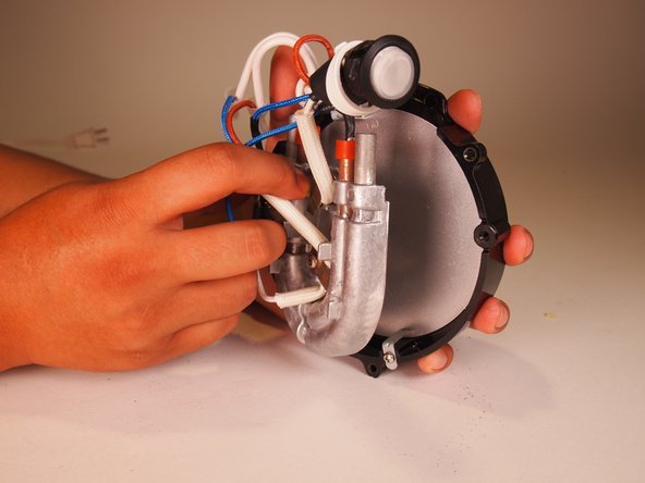

    • Using the Phillips #1 screwdriver, remove the two 11.5 mm screws on either side of the horizontal metal bracket.
  14. Krups CafeExpress FMA110 Disassembly: crwdns2935265:014crwdnd2935265:01crwdnd2935265:01crwdne2935265:0
    • Remove the horizontal bracket to separate the heating element and wires from the hot plate.

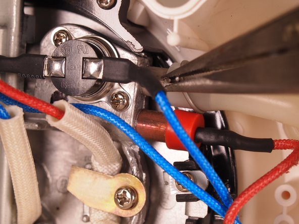

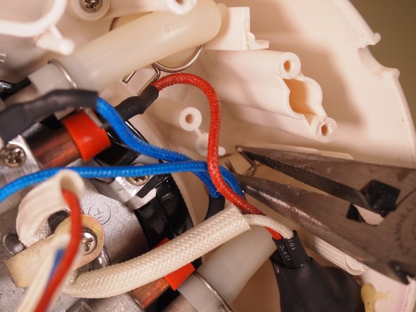

    • Disconnect the wire connectors from the thermal switch.
  16. Krups CafeExpress FMA110 Disassembly: crwdns2935265:016crwdnd2935265:01crwdnd2935265:01crwdne2935265:0

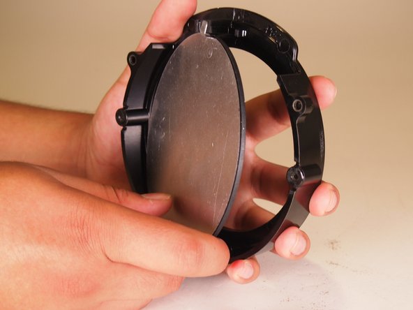

    • Using the Phillips #1 screwdriver, remove the two 9.9 mm screws from the hot plate.
    • Separate the hot plate from its frame.
