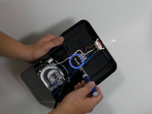

    • Use a Phillips size 2 screwdriver to remove the four 12mm screws found on the bottom of the machine.
  2. Krups 963 Power Cord Replacement: crwdns2935265:02crwdnd2935265:01crwdnd2935265:01crwdne2935265:0
    • Remove the single black Phillips size 0 10mm length screw on the back of the machine.
  3. Krups 963 Power Cord Replacement: crwdns2935265:03crwdnd2935265:01crwdnd2935265:01crwdne2935265:0
    • Remove the bottom cover from the machine and slide it down the power cord.
  4. Krups 963 Power Cord Replacement, Power Cord: crwdns2935265:04crwdnd2935265:01crwdnd2935265:02crwdne2935265:0 Krups 963 Power Cord Replacement, Power Cord: crwdns2935265:04crwdnd2935265:02crwdnd2935265:02crwdne2935265:0
    • Use the PH2 (or similar) screw driver to remove the two 12mm screws holding the clear restraining brace.
    • Remove the restraining brace from the machine base.
  5. Krups 963 Power Cord Replacement: crwdns2935265:05crwdnd2935265:01crwdnd2935265:01crwdne2935265:0
    • Use a 2.0 flat head (or similar) screw driver to loosen the screw holding the power cord in.
