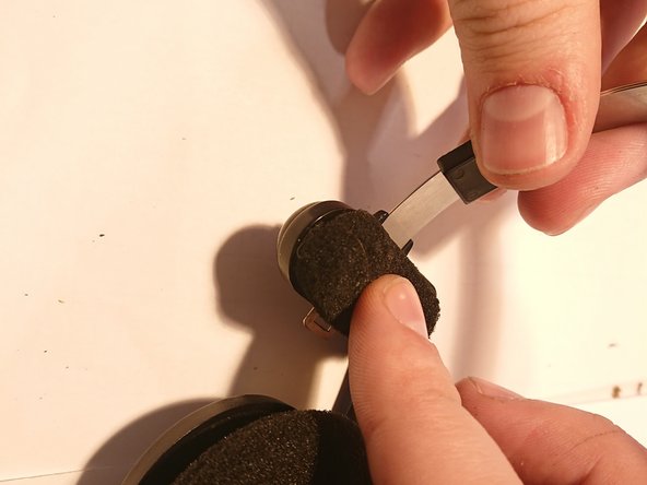

  1. Koss Porta Pro Speaker Holder Replacement, Remove cushion: crwdns2935265:01crwdnd2935265:01crwdnd2935265:03crwdne2935265:0 Koss Porta Pro Speaker Holder Replacement, Remove cushion: crwdns2935265:01crwdnd2935265:02crwdnd2935265:03crwdne2935265:0 Koss Porta Pro Speaker Holder Replacement, Remove cushion: crwdns2935265:01crwdnd2935265:03crwdnd2935265:03crwdne2935265:0

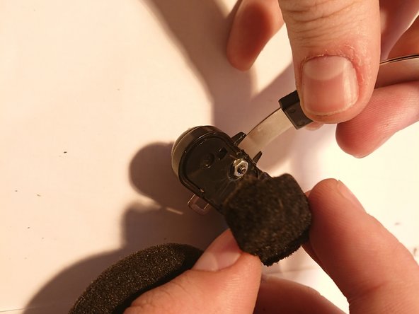

    • Remove cushion using knife.
  2. Koss Porta Pro Speaker Holder Replacement, Remove comfortZone label: crwdns2935265:02crwdnd2935265:01crwdnd2935265:02crwdne2935265:0 Koss Porta Pro Speaker Holder Replacement, Remove comfortZone label: crwdns2935265:02crwdnd2935265:02crwdnd2935265:02crwdne2935265:0
    • Remove label using flat screwdriver.

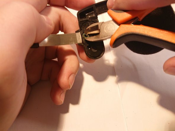

  3. Koss Porta Pro Speaker Holder Replacement, Remove clip: crwdns2935265:03crwdnd2935265:01crwdnd2935265:03crwdne2935265:0 Koss Porta Pro Speaker Holder Replacement, Remove clip: crwdns2935265:03crwdnd2935265:02crwdnd2935265:03crwdne2935265:0 Koss Porta Pro Speaker Holder Replacement, Remove clip: crwdns2935265:03crwdnd2935265:03crwdnd2935265:03crwdne2935265:0
    • Use screwdriver to start bending edges of clip.
    • Continue bending with pliers or cutters.
    • Push clip with screwdriver and pull with cutters from another side.
    • This step can take up to 15 minutes, so keep calm and continue bending.

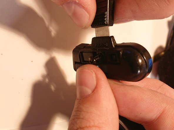

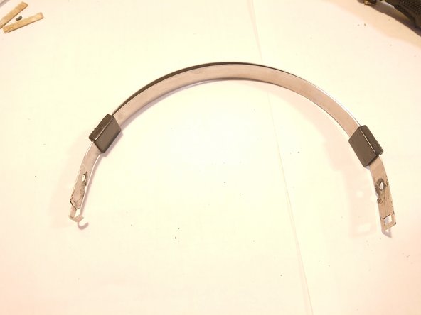

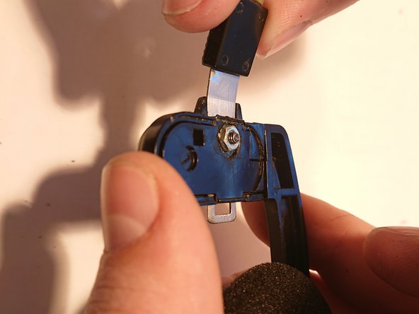

  4. Koss Porta Pro Speaker Holder Replacement, Remove hoop holder: crwdns2935265:04crwdnd2935265:01crwdnd2935265:03crwdne2935265:0 Koss Porta Pro Speaker Holder Replacement, Remove hoop holder: crwdns2935265:04crwdnd2935265:02crwdnd2935265:03crwdne2935265:0 Koss Porta Pro Speaker Holder Replacement, Remove hoop holder: crwdns2935265:04crwdnd2935265:03crwdnd2935265:03crwdne2935265:0
    • Press tenon using screwdriver to remove shield.
    • Remove hoop from hoop holder.

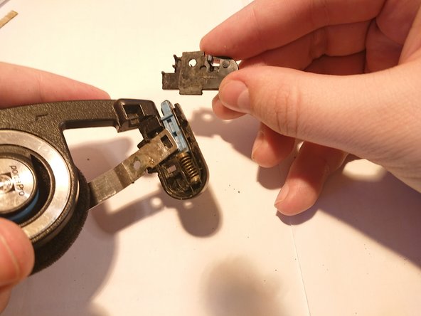

  5. Koss Porta Pro Speaker Holder Replacement, Assemble hoop holder: crwdns2935265:05crwdnd2935265:01crwdnd2935265:03crwdne2935265:0 Koss Porta Pro Speaker Holder Replacement, Assemble hoop holder: crwdns2935265:05crwdnd2935265:02crwdnd2935265:03crwdne2935265:0 Koss Porta Pro Speaker Holder Replacement, Assemble hoop holder: crwdns2935265:05crwdnd2935265:03crwdnd2935265:03crwdne2935265:0
    • Place hoop in hoop holer.
    • Close hoop holder with shield.

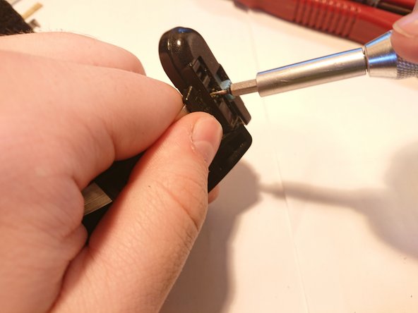

    • Insert M2.5x8 screw into hole and tighten the nut.
  6. Koss Porta Pro Speaker Holder Replacement, Stick cushion and label: crwdns2935265:06crwdnd2935265:01crwdnd2935265:03crwdne2935265:0 Koss Porta Pro Speaker Holder Replacement, Stick cushion and label: crwdns2935265:06crwdnd2935265:02crwdnd2935265:03crwdne2935265:0 Koss Porta Pro Speaker Holder Replacement, Stick cushion and label: crwdns2935265:06crwdnd2935265:03crwdnd2935265:03crwdne2935265:0
    • Stick comfortZone label over the screw. Use double-sided foam tape if head of screw is too high.
    • Stick cushion. Use additional double-sided tape if cushion has bad holding.
Left and right sides are the same so you can use this guide for both.
