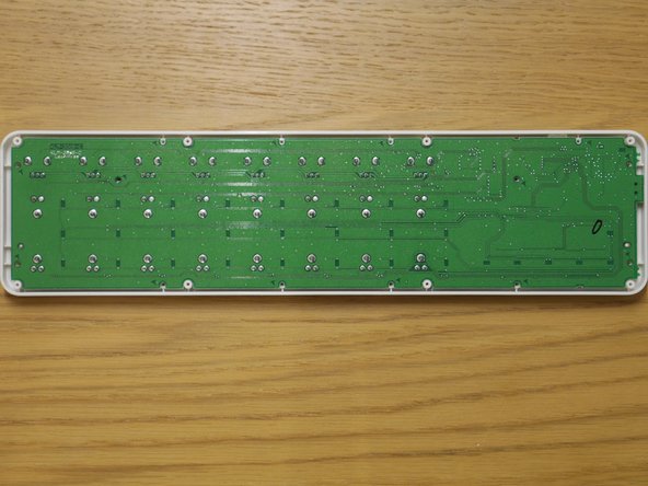

    • After opening back lid, remove 14 screws from inside.
  4. Korg nanoKONTROL2 Disassembly: crwdns2935265:04crwdnd2935265:01crwdnd2935265:03crwdne2935265:0 Korg nanoKONTROL2 Disassembly: crwdns2935265:04crwdnd2935265:02crwdnd2935265:03crwdne2935265:0 Korg nanoKONTROL2 Disassembly: crwdns2935265:04crwdnd2935265:03crwdnd2935265:03crwdne2935265:0

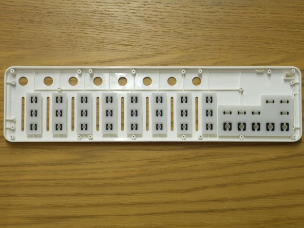

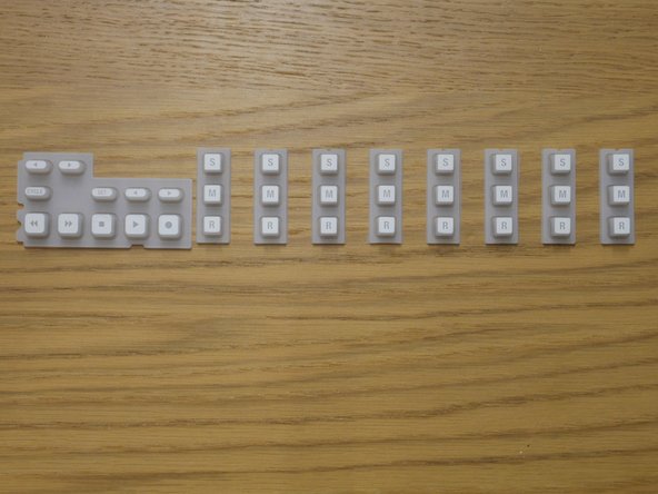

    • You can now remove the main circuit board, lifting out the left side first. (as the mini-USB port may hold the right side in.)
    • The rubber buttons can now easily come out.

    • 8 x Solo, Mute, Record buttons
    • 5 + 4 transport buttons
    • 2 track buttons
  6. Korg nanoKONTROL2 Disassembly: crwdns2935265:06crwdnd2935265:01crwdnd2935265:02crwdne2935265:0 Korg nanoKONTROL2 Disassembly: crwdns2935265:06crwdnd2935265:02crwdnd2935265:02crwdne2935265:0
    • Chips
    • Labelled with: 2210CFP24V H8S/2210C TH30140 1325
    • ROSON Crystal oscillator, labelled with 24.000F20 HO
    • LW051A 58A04 P256 Texas Instruments Analog multiplexer
    • Mini-usb port
    • Power indicator LED
