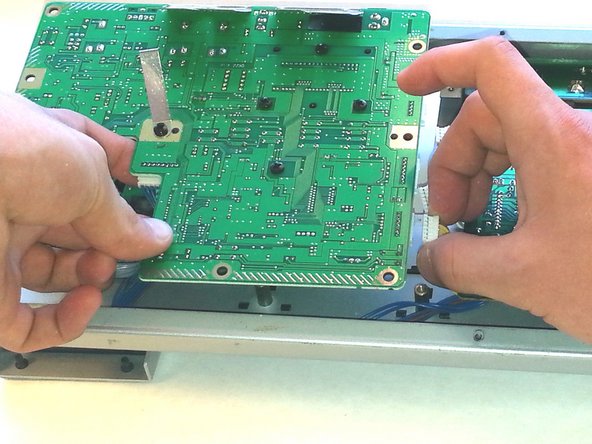

  5. Korg ToneWorks AX1500G Pedal Switch Replacement: crwdns2935265:05crwdnd2935265:01crwdnd2935265:03crwdne2935265:0 Korg ToneWorks AX1500G Pedal Switch Replacement: crwdns2935265:05crwdnd2935265:02crwdnd2935265:03crwdne2935265:0 Korg ToneWorks AX1500G Pedal Switch Replacement: crwdns2935265:05crwdnd2935265:03crwdnd2935265:03crwdne2935265:0
    • The circuit board is still connected at this point.
    • Carefully pull out the circuit board and turn it over.
    • Unplug the last cable connecting it to the other large circuit board.

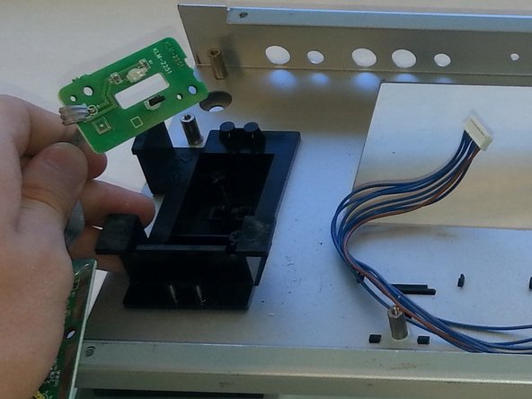

  6. Korg ToneWorks AX1500G Pedal Switch Replacement: crwdns2935265:06crwdnd2935265:01crwdnd2935265:01crwdne2935265:0
    • Unscrew the two 8.0 mm black Phillips screws from the small circuit board.
  7. Korg ToneWorks AX1500G Pedal Switch Replacement: crwdns2935265:07crwdnd2935265:01crwdnd2935265:03crwdne2935265:0 Korg ToneWorks AX1500G Pedal Switch Replacement: crwdns2935265:07crwdnd2935265:02crwdnd2935265:03crwdne2935265:0 Korg ToneWorks AX1500G Pedal Switch Replacement: crwdns2935265:07crwdnd2935265:03crwdnd2935265:03crwdne2935265:0

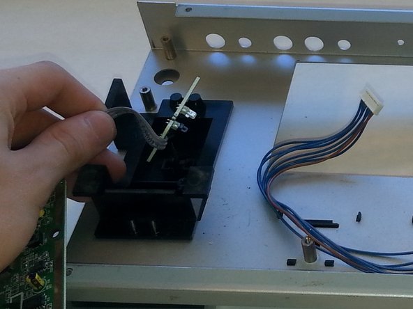

    • Gently pull out the small circuit board by the purple wire.
  8. Korg ToneWorks AX1500G Pedal Switch Replacement: crwdns2935265:08crwdnd2935265:01crwdnd2935265:03crwdne2935265:0 Korg ToneWorks AX1500G Pedal Switch Replacement: crwdns2935265:08crwdnd2935265:02crwdnd2935265:03crwdne2935265:0 Korg ToneWorks AX1500G Pedal Switch Replacement: crwdns2935265:08crwdnd2935265:03crwdnd2935265:03crwdne2935265:0
    • Mark the wire connected to the small circuit board so for future reference.

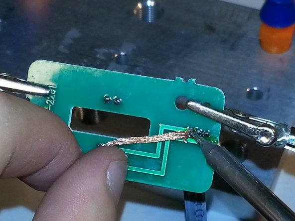

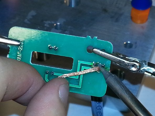

    • Soldering Irons can be very dangerous if you are inexperienced.
    • Desolder the wires connecting to the board and remove the board.
    • Solder the new foot switch circuit on

Thanks! My Ax1500g's pedal switch volume is failing, and not reaching the 100% volume, not even 50%. I've opened the pedalboard and removed the pedal switch, but I notice It doesn't have any true connection to the switchboard but an LED with a PhotoSensor that may be blocked by a plastic in the pedal itself, is that how it works? I was expecting a Potenciometer.
Where can I buy the pedal switch board replacement?
309001200 PHOTO TR RPM-22PB N OR P KLM-2251 AX150 1
312051900 PHOTO SENSOR SIM-22ST Q OR R KLM-2251 AX150 1
Thanks

My friend briought me his AX1500G, the expression pedal isn't working, nor volume or wah,...
I can't buy the interuptor, I check voltages on the three cables connection, it's ok. I think something wrong happened with the IR coupple, touching the cable ends on the main pcb while pressing the pedal, it sounding whooaa.. , that signal is working.
I think the IR sensor( reciever) is receiving the IR led (transmitter) but the value of resistance of the sensor had decreased and voltage output increase. Maybe by the age, maybe by long time using. I put a resistor (100k, I put this resistor due to resistance of my finger tip ) to jumps the output to ground for decreasing signal. It's works. The pedal can be using again.
