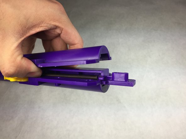

    • Pull the shell of the central firing assembly aside off (contains the loading spring).
  11. Koosh Vortex Tornado Loading Spring Replacement: crwdns2935265:011crwdnd2935265:01crwdnd2935265:02crwdne2935265:0 Koosh Vortex Tornado Loading Spring Replacement: crwdns2935265:011crwdnd2935265:02crwdnd2935265:02crwdne2935265:0
    • Open the back side of the central firing assembly apart to expose the loading spring. Remove it, and change it with your desired spring.
    • The two sides cannot be fully separated due to a pin holding the yellow collar tightly together.
