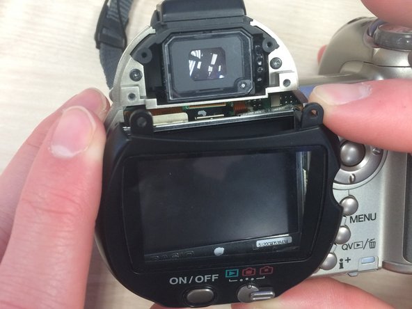

    • Use a Phillips #000 screwdriver to remove the two black screws above the LCD screen.
    • Remove the black view protector.
    • Remove the screen cover by applying slight force at the top, then pulling away from the camera.

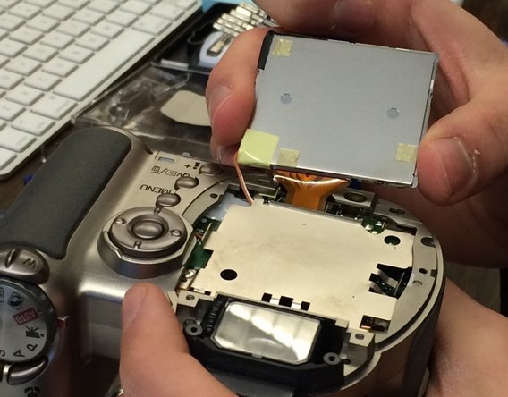

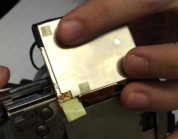

    • Carefully use the spudger to pop the LCD screen out of the bracket.
    • The LCD screen should still be attached by orange ribbon cable and two wires, one orange and one white.
    • Use tweezers to carefully pull the ribbon cable from the logic board, not from the LCD screen.
    • Peel back the yellow tape on LCD screen to reveal where the two wires are attached. Use tweezers to detach the orange and white wires from the LCD screen.
    • Attach the wires to the new screen in the same spot they were attached to the old one.
    • Attach the new screen's ribbon tape to the logic board underneath the metal plate.
    • With the new screen attached, put it in place on the metal plate. You can now replace the screen cover.
