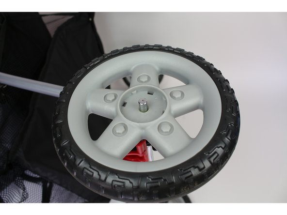

    • Applying too much force to the spudger can cause the spudger to bend or the hubcap to break. To avoid this, try prying the hubcap from a different angle or positioning your spudger at a different points around the hubcap.
    • Use the spaded side of the metal spudger to pry off the small black hubcap on the outside of the rear wheel.
  2. Kolcraft Cloud Plus Wheel Replacement: crwdns2935265:02crwdnd2935265:01crwdnd2935265:02crwdne2935265:0 Kolcraft Cloud Plus Wheel Replacement: crwdns2935265:02crwdnd2935265:02crwdnd2935265:02crwdne2935265:0
    • Pull on the looped end of the cotter pin to remove it.
  3. Kolcraft Cloud Plus Wheel Replacement: crwdns2935265:03crwdnd2935265:01crwdnd2935265:02crwdne2935265:0 Kolcraft Cloud Plus Wheel Replacement: crwdns2935265:03crwdnd2935265:02crwdnd2935265:02crwdne2935265:0
    • Remove the metal washer by sliding it off the axle.
  4. Kolcraft Cloud Plus Wheel Replacement: crwdns2935265:04crwdnd2935265:01crwdnd2935265:01crwdne2935265:0
    • Slide the wheel off of the axle.
