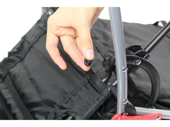

  7. Kolcraft Cloud Plus Seat Replacement: crwdns2935265:07crwdnd2935265:01crwdnd2935265:02crwdne2935265:0 Kolcraft Cloud Plus Seat Replacement: crwdns2935265:07crwdnd2935265:02crwdnd2935265:02crwdne2935265:0
    • Unscrew 14mm Phillips #2 screw on the underside of the stroller and repeat this process for the opposite side.
    • Remove the plastic washers.
    • These plastic washers are circular to better fit around the frame. Remember that these locations require the circular washers.

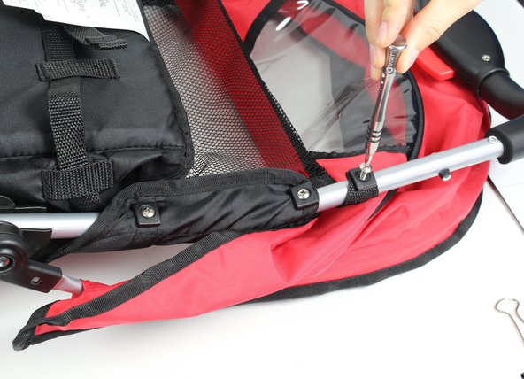

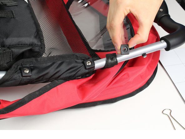

  9. Kolcraft Cloud Plus Seat Replacement: crwdns2935265:09crwdnd2935265:01crwdnd2935265:01crwdne2935265:0
    • Unscrew the 14mm Phillips #2 screws located under the cover on either side of the inside frame.

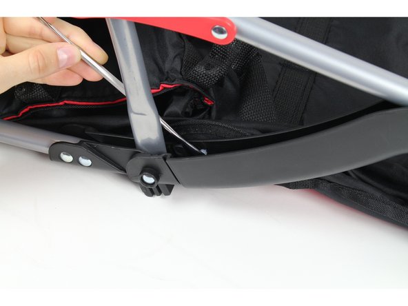

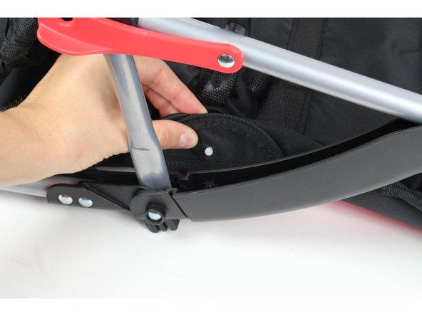

  10. Kolcraft Cloud Plus Seat Replacement: crwdns2935265:010crwdnd2935265:01crwdnd2935265:03crwdne2935265:0 Kolcraft Cloud Plus Seat Replacement: crwdns2935265:010crwdnd2935265:02crwdnd2935265:03crwdne2935265:0 Kolcraft Cloud Plus Seat Replacement: crwdns2935265:010crwdnd2935265:03crwdnd2935265:03crwdne2935265:0
    • Using the spudger, pop out the small, white ball that's on the underside of the plastic part of the frame. Repeat this process for the opposite side.
    • Brace the spudger against the frame—it will provide the extra force needed to pop the white balls through their holes.

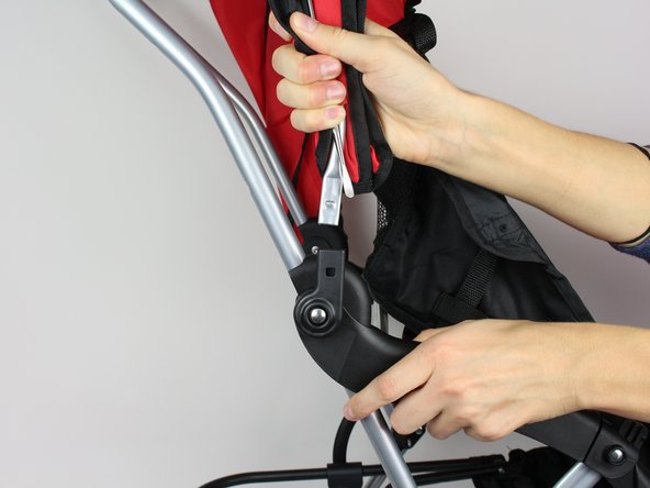

  11. Kolcraft Cloud Plus Seat Replacement: crwdns2935265:011crwdnd2935265:01crwdnd2935265:02crwdne2935265:0 Kolcraft Cloud Plus Seat Replacement: crwdns2935265:011crwdnd2935265:02crwdnd2935265:02crwdne2935265:0
    • Place the metal spudger between the plastic connector and the metal frame of the sun shade.
    • Use the spudger to pry outwards on the plastic while simultaneously pulling straight up on the metal frame of the sun shade.
    • Repeat this process for the opposite side to completely remove the seat.
    • Use one hand to brace the frame of the stroller by firmly pushing down on the plastic part of the frame.
