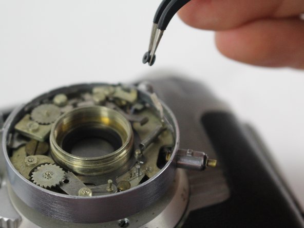

If the shutter on your Kodak Signet 35 isn't working properly, then the shutter spring may need to be cleaned or replaced. This guide will show you how. Please make sure you have all the necessary tools, as well as a clean and stable surface on which to work, before you start these steps.
    1. Kodak Signet 35 Shutter Spring Replacement, Shutter Spring: crwdns2935265:01crwdnd2935265:01crwdnd2935265:03crwdne2935265:0 Kodak Signet 35 Shutter Spring Replacement, Shutter Spring: crwdns2935265:01crwdnd2935265:02crwdnd2935265:03crwdne2935265:0 Kodak Signet 35 Shutter Spring Replacement, Shutter Spring: crwdns2935265:01crwdnd2935265:03crwdnd2935265:03crwdne2935265:0
      • While the camera is lying on its back, unscrew the front lens assembly and remove the lens and the faceplate. Then lift off the speed setting.

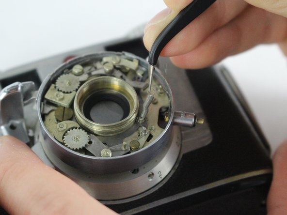

    2. Kodak Signet 35 Shutter Spring Replacement: crwdns2935265:02crwdnd2935265:01crwdnd2935265:02crwdne2935265:0 Kodak Signet 35 Shutter Spring Replacement: crwdns2935265:02crwdnd2935265:02crwdnd2935265:02crwdne2935265:0
      • Remove the lever from the stopper by pushing it back and then upwards.
    3. Kodak Signet 35 Shutter Spring Replacement: crwdns2935265:03crwdnd2935265:01crwdnd2935265:02crwdne2935265:0 Kodak Signet 35 Shutter Spring Replacement: crwdns2935265:03crwdnd2935265:02crwdnd2935265:02crwdne2935265:0
      • Remove the stopper by lifting it upwards with the tweezers.

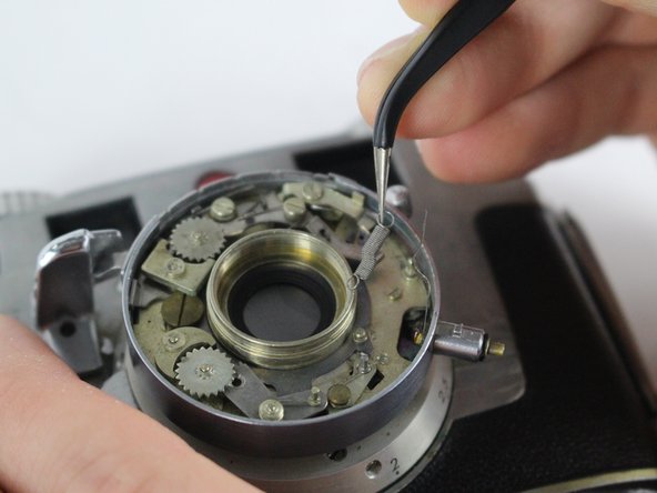

    4. Kodak Signet 35 Shutter Spring Replacement: crwdns2935265:04crwdnd2935265:01crwdnd2935265:03crwdne2935265:0 Kodak Signet 35 Shutter Spring Replacement: crwdns2935265:04crwdnd2935265:02crwdnd2935265:03crwdne2935265:0 Kodak Signet 35 Shutter Spring Replacement: crwdns2935265:04crwdnd2935265:03crwdnd2935265:03crwdne2935265:0
      • Using tweezers, unhitch the spring from the base and remove it by lifting upwards.

What kind of spring can be used to replace it or how would one revitalize the old spring?
Ben Le - crwdns2934203:0crwdne2934203:0 crwdns2950251:0crwdne2950251:0
What does “front lens assembly” look like? what parts do I have to unscrew?
Shawn Reynolds - crwdns2934203:0crwdne2934203:0 crwdns2950251:0crwdne2950251:0
The part that needs to be unscrewed is the silver collar right around the black lens element. This instructable could do with another photo showing this.
