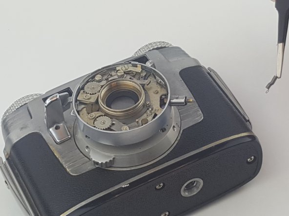

    • Unscrew the front lens assembly. Then, lift off the faceplate underneath and the speed setting plate.

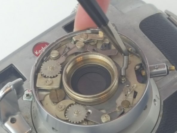

    • using a tweezers take out the black nob

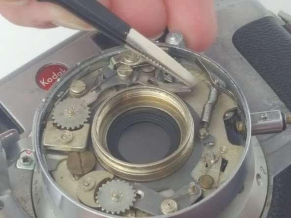

    • Replace old spring with new one
