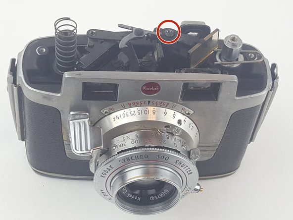

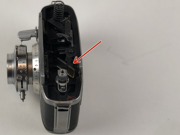

    • Using a Phillips head screwdriver, remove the vertical-facing Phillips screw that holds the metal bracket in place located near the viewfinder.

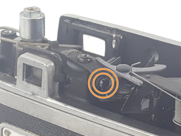

    • Using a 2.5mm flathead screw driver, gently loosen the horizontal screw that holds the metal bracket just enough to make it easier to release the beamsplitter.
    • Be cautious when reassembling the device, DO NOT tighten the horizontal flathead screw all the way. Tighten the screw enough to where the beamsplitter is held in place and then stop.

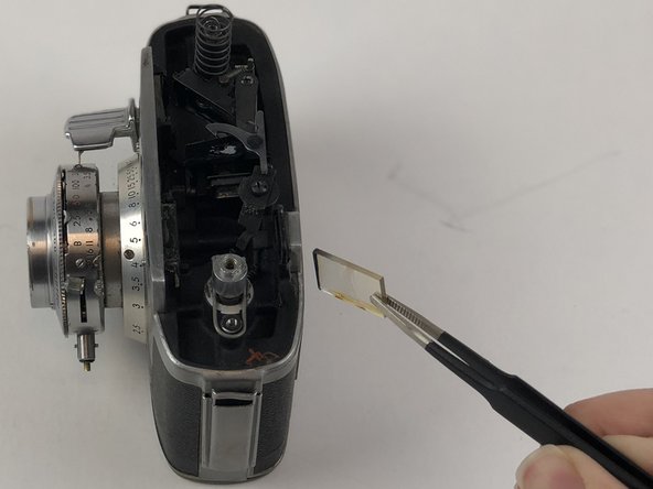

    • Remove the beamsplitter using the tweezers. It can now be cleaned or replaced.

Assembling note.The hooked arm for the film counter dial needs to be held back so it will hit the counter ratchet wheel. I did it with the waxed paper left over from double-sided tape. You can stick the paper so the hook arm is held back from its normal moving position. Once the lid is held in place you carefully pull the paper out. Otherwise you will struggle with the counter as the catch won’t hit the ratchet wheel.
