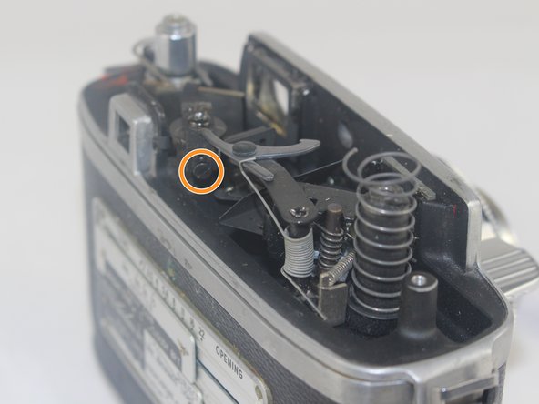

    • Using the Phillips head screwdriver, remove the vertical-facing 2.1mm Phillips #00 screw that holds the metal bracket in place and set it aside.
    • With the 2.5mm flathead screwdriver, loosen the horizontal-facing 2.1mm flathead screw that holds the metal bracket in place and set it aside.
    • When reassembling the device, DO NOT tighten the 2.1mm flathead screw all the way. Tighten the screw until the beamsplitter is held in its proper position and then stop.

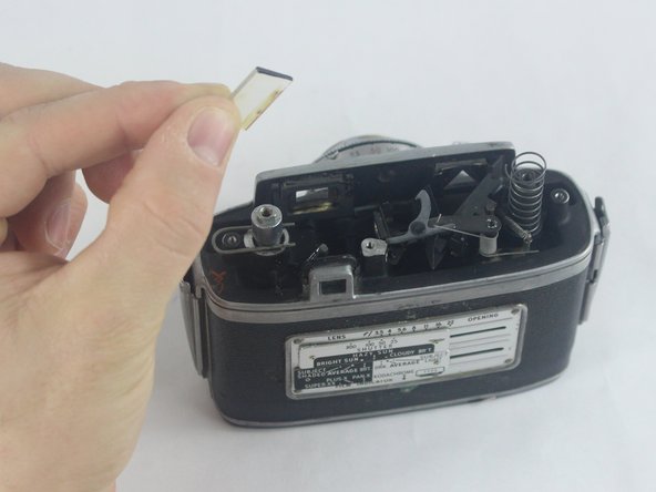

    • Remove the metal bracket that holds the beamsplitter in place and set it aside.
    • Remove the beamsplitter. It can now be cleaned or replaced.

I feel like the beamsplitter's position can change a great deal depending on how lose the arm is and after cleaning/repair it definitely shifts. How does one position it properly?
I just cleaned mine and now I see two triangles at the bottom of the viewfinder (used to see nothing because the glass elements were all very dirty).
