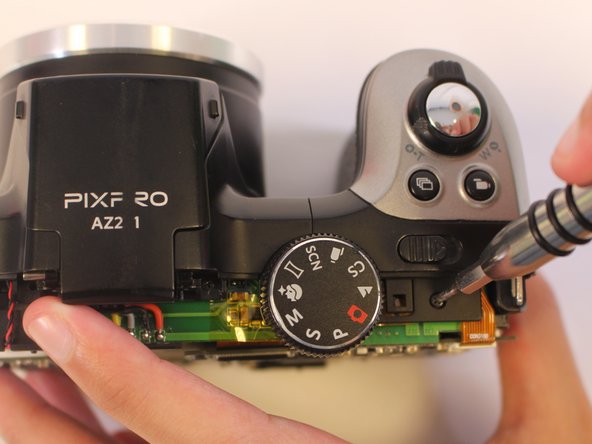

  12. Kodak PixPro AZ251 Shutter Button Replacement, Shutter Button: crwdns2935265:012crwdnd2935265:01crwdnd2935265:02crwdne2935265:0 Kodak PixPro AZ251 Shutter Button Replacement, Shutter Button: crwdns2935265:012crwdnd2935265:02crwdnd2935265:02crwdne2935265:0
    • Remove one 4mm JIS #000 screw from the top of the camera.

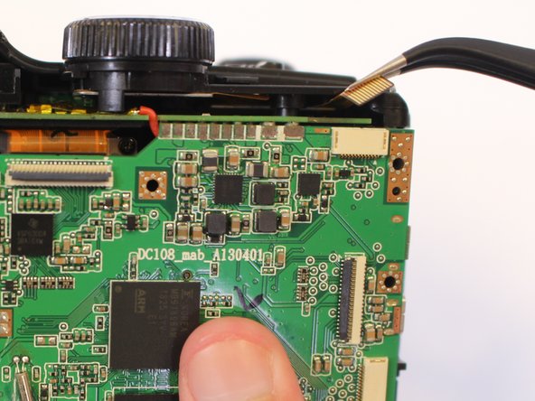

  13. Kodak PixPro AZ251 Shutter Button Replacement: crwdns2935265:013crwdnd2935265:01crwdnd2935265:02crwdne2935265:0 Kodak PixPro AZ251 Shutter Button Replacement: crwdns2935265:013crwdnd2935265:02crwdnd2935265:02crwdne2935265:0
    • Using tweezers, disconnect the orange cable connection at the top of the motherboard.

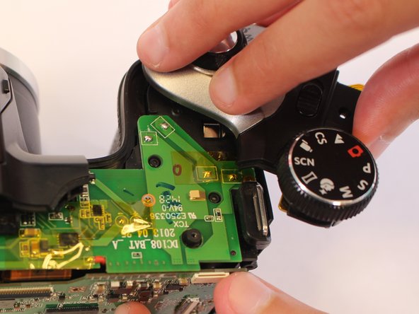

  14. Kodak PixPro AZ251 Shutter Button Replacement: crwdns2935265:014crwdnd2935265:01crwdnd2935265:02crwdne2935265:0 Kodak PixPro AZ251 Shutter Button Replacement: crwdns2935265:014crwdnd2935265:02crwdnd2935265:02crwdne2935265:0
    • Pull the mode dial up and off of the camera.
    • Rotate carefully to avoid breaking the screw attaching the top side cover to the main body of the camera.

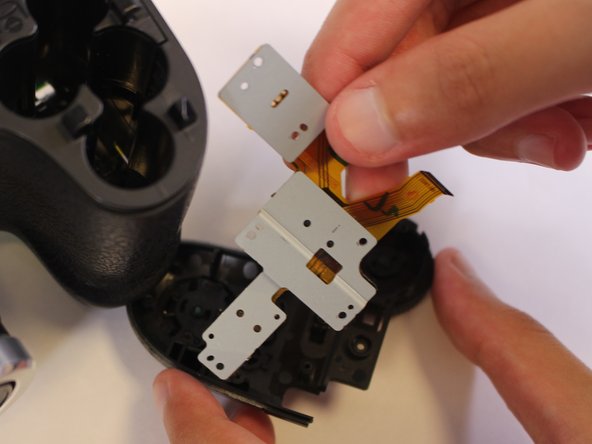

    • Remove the six 2mm JIS #000 screws from the metal base of the shutter button.
  16. Kodak PixPro AZ251 Shutter Button Replacement: crwdns2935265:016crwdnd2935265:01crwdnd2935265:02crwdne2935265:0 Kodak PixPro AZ251 Shutter Button Replacement: crwdns2935265:016crwdnd2935265:02crwdnd2935265:02crwdne2935265:0
    • Remove the metal base and ribbon cables.
