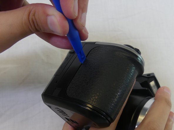

  4. Kodak PixPro AZ251 Rubber Grip Replacement, Rubber Grip: crwdns2935265:04crwdnd2935265:01crwdnd2935265:01crwdne2935265:0
    • Insert the plastic opening tool underneath the rubber on the bottom corner.

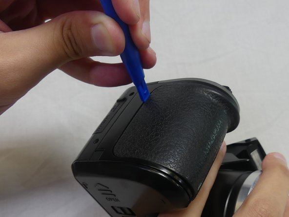

  5. Kodak PixPro AZ251 Rubber Grip Replacement: crwdns2935265:05crwdnd2935265:01crwdnd2935265:03crwdne2935265:0 Kodak PixPro AZ251 Rubber Grip Replacement: crwdns2935265:05crwdnd2935265:02crwdnd2935265:03crwdne2935265:0 Kodak PixPro AZ251 Rubber Grip Replacement: crwdns2935265:05crwdnd2935265:03crwdnd2935265:03crwdne2935265:0
    • Slide the plastic opening tool along the perimeter of the rubber grip to unbind the glue.

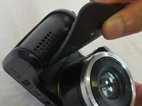

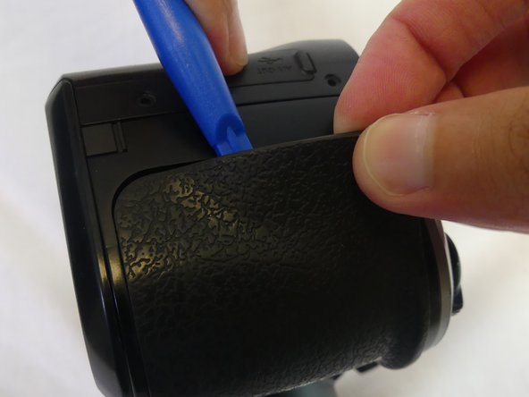

  6. Kodak PixPro AZ251 Rubber Grip Replacement: crwdns2935265:06crwdnd2935265:01crwdnd2935265:03crwdne2935265:0 Kodak PixPro AZ251 Rubber Grip Replacement: crwdns2935265:06crwdnd2935265:02crwdnd2935265:03crwdne2935265:0 Kodak PixPro AZ251 Rubber Grip Replacement: crwdns2935265:06crwdnd2935265:03crwdnd2935265:03crwdne2935265:0
    • Pry upwards until you can grip the rubber enough to pull off.
