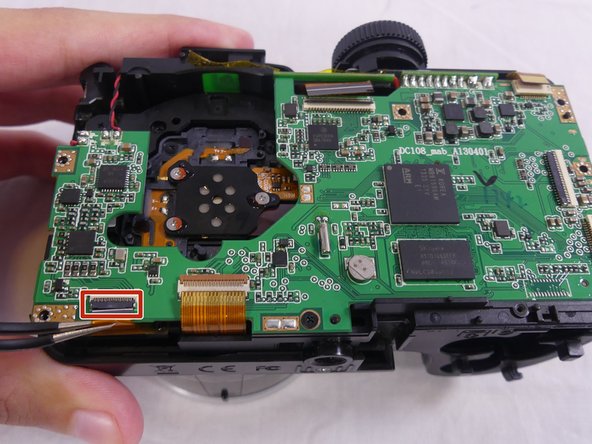

  16. Kodak PixPro AZ251 Motherboard Replacement: crwdns2935265:016crwdnd2935265:01crwdnd2935265:02crwdne2935265:0 Kodak PixPro AZ251 Motherboard Replacement: crwdns2935265:016crwdnd2935265:02crwdnd2935265:02crwdne2935265:0
    • Remove the rectangular black cushion pad on the bottom left of the motherboard by pulling it upwards with your hands.
    • Use a spudger to flip up the retaining flap on the ribbon cable ZIF socket.
    • Disconnect the orange cable by pulling it outwards with tweezers.
