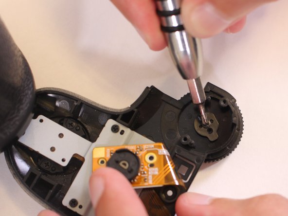

    • Turn the camera upside down.
    • Remove two 2mm JIS #000 screws from the metal base of the mode dial.
  16. Kodak PixPro AZ251 Mode Dial Replacement: crwdns2935265:016crwdnd2935265:01crwdnd2935265:02crwdne2935265:0 Kodak PixPro AZ251 Mode Dial Replacement: crwdns2935265:016crwdnd2935265:02crwdnd2935265:02crwdne2935265:0
    • Lift the metal base and remove the 4mm JIS #000 screw from the center of the mode dial.
  17. Kodak PixPro AZ251 Mode Dial Replacement: crwdns2935265:017crwdnd2935265:01crwdnd2935265:02crwdne2935265:0 Kodak PixPro AZ251 Mode Dial Replacement: crwdns2935265:017crwdnd2935265:02crwdnd2935265:02crwdne2935265:0
    • The mode dial should now be loose and can be easily removed from the top side cover.
    • Turn the mode dial upside down to remove the metal part inside.
