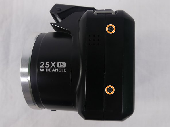

    • Remove a total of four 5mm JIS #000 screws from around the camera:
    • Two screws from the right side.
    • Two screws from the left side.

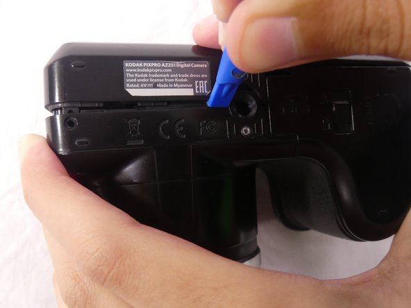

  5. Kodak PixPro AZ251 LCD Screen Replacement: crwdns2935265:05crwdnd2935265:01crwdnd2935265:01crwdne2935265:0
    • Remove the single 5mm Phillips #00 screw from the bottom.

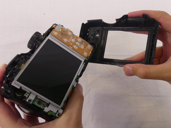

  7. Kodak PixPro AZ251 LCD Screen Replacement: crwdns2935265:07crwdnd2935265:01crwdnd2935265:03crwdne2935265:0 Kodak PixPro AZ251 LCD Screen Replacement: crwdns2935265:07crwdnd2935265:02crwdnd2935265:03crwdne2935265:0 Kodak PixPro AZ251 LCD Screen Replacement: crwdns2935265:07crwdnd2935265:03crwdnd2935265:03crwdne2935265:0
    • Use a plastic opening tool to pry apart both halves of the camera.
    • Remove the back panel.

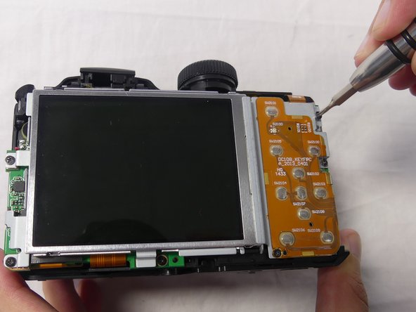

    • Remove these three JIS #000 screws from the control board:
    • 5mm screw.
    • 4mm screw.
    • 2mm screw.
  9. Kodak PixPro AZ251 LCD Screen Replacement: crwdns2935265:09crwdnd2935265:01crwdnd2935265:01crwdne2935265:0
    • Pull the small metal switch plate to the side.
  10. Kodak PixPro AZ251 LCD Screen Replacement: crwdns2935265:010crwdnd2935265:01crwdnd2935265:02crwdne2935265:0 Kodak PixPro AZ251 LCD Screen Replacement: crwdns2935265:010crwdnd2935265:02crwdnd2935265:02crwdne2935265:0
    • Pry the LCD screen out of the metal housing plate with a plastic opening tool.

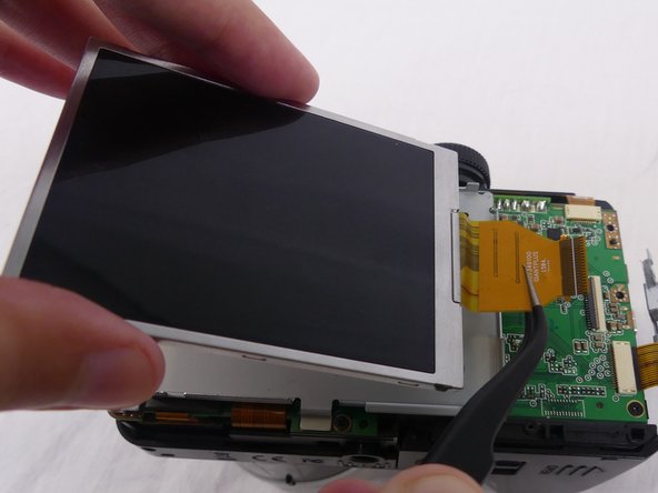

  11. Kodak PixPro AZ251 LCD Screen Replacement: crwdns2935265:011crwdnd2935265:01crwdnd2935265:02crwdne2935265:0 Kodak PixPro AZ251 LCD Screen Replacement: crwdns2935265:011crwdnd2935265:02crwdnd2935265:02crwdne2935265:0
    • Use a spudger to flip up the retaining flap on the display ribbon cable ZIF socket.
    • Pull the orange cable out of the socket.
